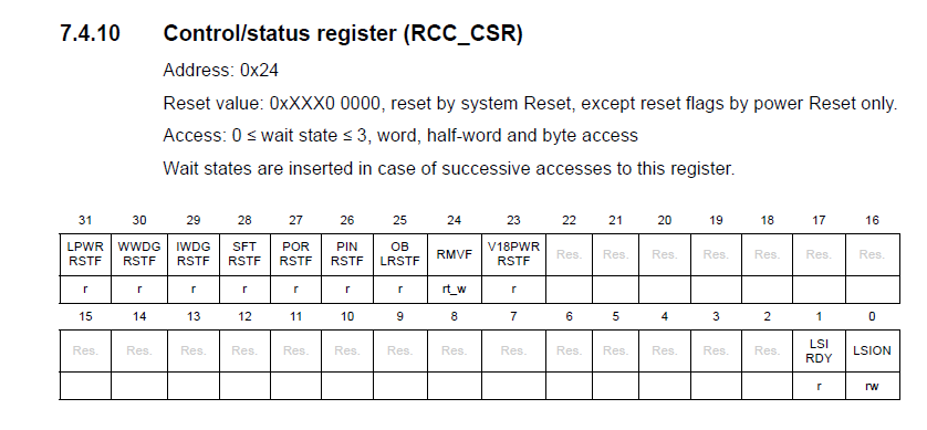

After it resets, what does the RCC_CSR register say about the source of the reset?

Your code is correct. it doesn't have any error.
Adc is not resetting the microcontroller.
you have to check the source of Reset by reading this register.0693W000003RTjVQAW.png

If I do not clear the the flags after check one by one, PORRST and SFTRSTF are set. If I clear the flags, SFTRSTF flag is set after reset. I'm using stlink to debug.
A question: when I use the "debug" option in cubeIDE, the code is uploaded and the debug "starts", correct? This can set some of these flags and influencing in the result?
Just the microprocessor. I made my own board to a specific solution.
But I checked the VDDA, and it was not connected! And as suggested by TDK and sanju, I checked the RCC_CSR register, and PORSTF and SFTRSTF are set. I connect VDDA to 3.3V and it works!!
