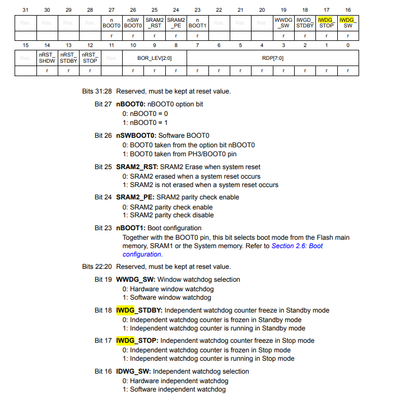

I tried to use the internal watchdog IWDG and WWDG) on an STM32L433
It worked fine until the device went into low power modes, standby and shutdown.
Because the watchdogs still runs during low power modes, but as the prcoessor is not running the watchdog times out and keeps resetting the processor.

  • To handle the watchdog in standby mode
did you try to use IWDG_STDBY option byte.
It should make you able to freeze the watchdog in the specific low power mode.
You can modify it using STM32CubeProgrammer.

Thanks Gyessine
I am aware of the IWDG_STDBY option byte but have not looked it, because it only solves the problem in standby, it does not solve the problem when in shutdown.  So a fix for standby is of no use if there is no fix for shutdown.
