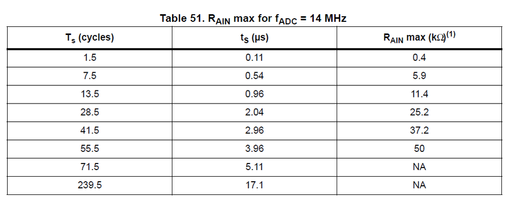

Table 51 on page 69 has "NA" listed for Ts of 71.5 and 239.5. There's no explanation as to why other than, as I see it, table 50 stating that the maximum external resistance is 50K.
What left me wondering is that this number seems to correspond to a 1/4 LSB maximum error at 12 bits.

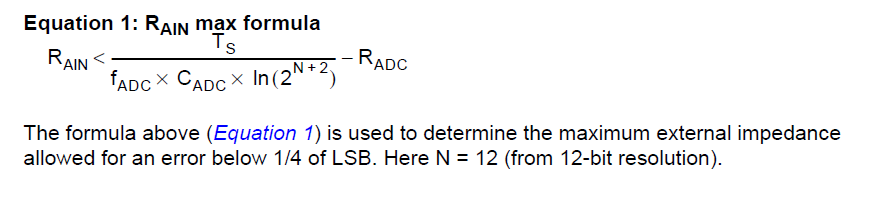

> I don't think that reducing resolution is helping you with input impedance.
Unless I am reading it wrong page 68 of the data sheet, equation 1, seems to indicate this is a factor:
0693W00000AMHVZQA5.pngOn this next page, Table 51, they provide results for the 12 bit case:

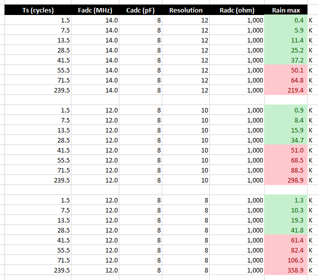

I reproduced this table and calculated the values for 10 and 8 bits and lowered the ADC clock to 12 MHz (the /4 I can use). According to this, yes, sampling rate and ADC width do give you the ability to use a larger Rin. However, the overriding fact seems to be that we are limited to 50K due mostly to leakage.
At this point I am thinking of a version of Uwe's external capacitor suggestion. I can't load the input too much because I am effectively measuring in the middle of the voltage divider for an op amp's feedback loop. I was trying to get clever and save a few components on this multi-channel design. It's looking like I won't be able to do this. My inputs can easily survive a quick low impedance sample. I could setup a FET-gated sample-and-hold using a larger capacitor to then drive the ADC input from a low impedance source. At some point the cost, complexity and errors introduced by such a solution is likely to just drive adding another set of op amps in unity gain and get on with it.
