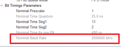

Another issue I've just detected in your configuration:
Nominal bitrate is at 2.5Mb/s!! You must not exceed 1Mb/s in the nominal phase with FDCAN.
