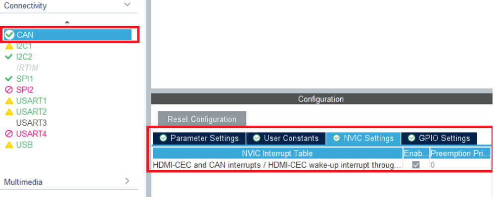

turned out the stby pin on the can transceiver needed to be explicitly grounded. Now I am able to Tx on the stm32f0. Unfortunately Rx does not work. There is no option to turn on rx interrupt handler in nvic settings
‎2021-09-21 1:50 AM
This is the option to enable CAN interrupt in CubeMx for F0:
