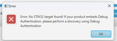

STM32CubeProgrammer Error: No STM32 target found!
2024-04-19 1:50 AM
I have a STM32F405RGT6 on a custom PCB and are using a ST-Link/V2 ISOL in my computer. A USB-Mini is conencted to the ST-Link and from the ST-Link I use RESET, SWCLK, SWIO and GND to my STM32.

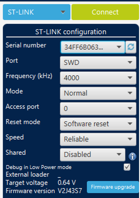

I have tried connecting to the ST-Link with the STM32CubeProgrammer with the following settings:
Port: SWD
Frequency: 4000
Mode: Normal
Access port: 0
Reset Mode: Software reset
Speed: Reliable
Shared: Disabled
Debug in Low Power mode: ON

After updating the driver I tried to connecting to the MCU and recieve the same error every time:
Error: No STM32 target found! If your product embeds Debug Authenication, please perfrom a discovery using Debug Authentication
(I have also tried with different settings and it gave the same error)

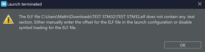

In the steps I have followed all the steps until 3.2 where I cant debug the main.c file in the Src folder.
I receive this error when trying to debug:

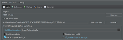

I have chosen the .elf file in the Debug folder as shown here:
How do I manually enter the offset for the ELF file in the lanch configuration or disable symbol loading for the ELF file?

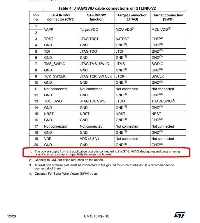

Might be the target does not have power. I have not connected the ST-link VDD input since the MCU recieves 3.3V from the PCB. Is it necessary to set 3.3V on the VDD pin?
2024-04-19 2:25 AM - edited 2024-04-19 2:31 AM
@mathieusteketee wrote:I have not connected the ST-link VDD input since the MCU recieves 3.3V from the PCB.
The purpose of the ST-Link's VAPP connection is not to supply power to the target, but for the ST-Link to detect that the target is powered. It's how the ST-Link knows that there's a Target connected.
It is also used as the reference for the ST-Link's voltage translators.
When the ST-Link does not detect power from the Target, it assumes that there is no Target present.
EDIT:
From the ST-Link User Manual:

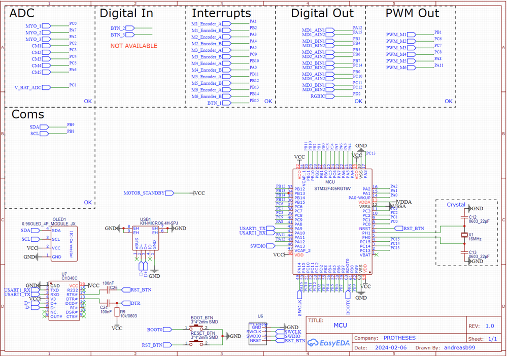

2024-04-19 2:31 AM
My applogies, here you go:

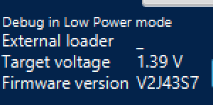

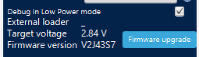

2024-04-19 3:18 AM
I have tried setting 3.3V to the VAPP, Pin 1, (also tried pin 2) and recieved 2.84VDC at the target voltage:
But it seems when I refresh it jumps to 1.39VDC. Is this normale?
However I still get the error (with 2.84VDC):

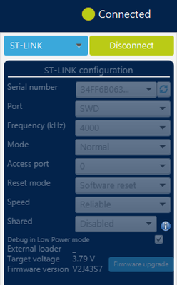

2024-04-19 3:30 AM
I noticed a wiring issue with the not having a common ground to the ST-link and then got 3.79V as the target voltage. Once I had the target voltage at 3.79V I could connect! Thank you Andrew for your help. Really appreciate it.
