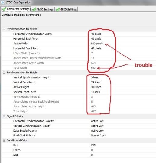

not working correctly setup window LTDC after opening already saved project
(see. screenshot)
after generating the project is not the correct parameters are passed to the C-project
Do you mean that project was generated initially with correct parameters then they were wrongly updated next time when project re-generated?
Could you please share an .ioc file?
Which CubeMX version are you using (last one is 4.7.0)

project for version 4.6
However, 4.7 is identical
Yes, the project had an initial generation parameters for LTDC default, after modifying the parameters are all displayed correctly and C-project also receives the correct settings LTDC.
Project is saved.
As described above, after the re-opening of the project there are problems ...
