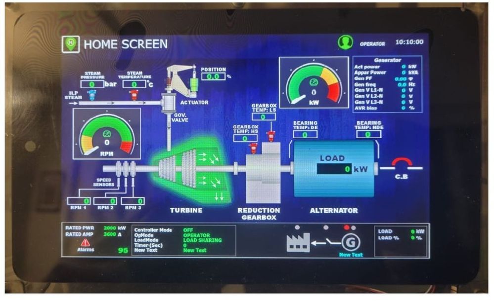

I have lot of experience with TouchGFx ..
Here is my latest experiment with Google Nexus 7 , 1280x800 TFT with stm32h745 board.
Here is my dev board with stm32h745
regards
