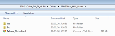

Hi yvraut.gerard,
All STM32Cube Packages contain HAL_Drivers Release_Notes file located in Hal driver folder: if you use STM32CubeF4 you can find it in this repository STM32Cube_FW_F4_V1.5.0\Drivers\STM32F4xx_HAL_Driver and the same for all STM32Cube packages.
Best regards,
Heisenberg.
stst9193
Posted on March 31, 2015 at 10:09
Hello Heisenberg,
This is exactly what i was looking for!!!
I would suggest to make it more visible to user
- copying it into the driver repository of every project created from MCube
- Having an easy/obvious way to open it from MCube itelf
Regards
