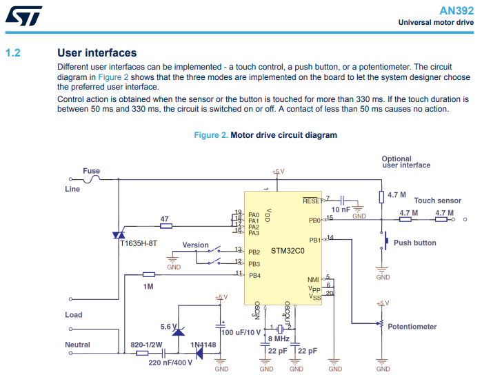

I am a little confused here, AN392 claims to run STM32C0 from a 5V power supply, directly from the main fed RCD dropper with a 5.6V Zener. But the datasheet says the maximum voltage is 4V.
So does the AN suggest running way over max specs or is there something I miss?

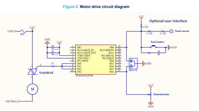

Issue fixed in AN392 Rev 4 / figure 2.

Good catch. Need to check this internally.
Andrew Neil
You mean this?

Internal ticket 178788 has been created to fix this. The ticket is not accessible by the community users.
mƎALLEm
