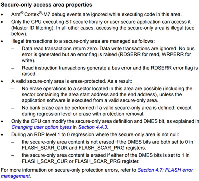

Good day everyone,
I am currently implementing an update process and I am facing some issues if I want to erase the internal flash memory sector if my code is running from an external OSPI-Flash. I am getting the errors:
I have not activated any readout-protection or anything. The only option Byte I have set is the write protection for the Flash Sector 1/2 (Depends on which one got updated last) But this error I am facing is related to the sector 3-7.
The same piece of code runs totaly fine if I am executing it from the internal flash memory, but due to memory constraints I have to use the external OSPI-Flash.
Attached you can find the output which exposes all option byte settings and the error code I have mentioned. And here the code snipped of the flash class:

Any help is highly appreciated as I am running out of ideas to find the root-cause or a work-arround.
Kind regards
2024-08-21 7:11 AM
Hello @sschneider,
Are you enabling the secure access mode? Is SECURITY bit in FLASH_OPTSR_CUR register set to1?
May be RM0468 section can help you to find the issue.
