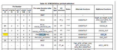

It looks like STM32H503 devices can meet these requirements, but only in the WLCSP25 package.

Looking at this a bit more, although the WLCSP25 package allows for CAN on some pins, it does not appear to have any high-speed clock input pins, which you probably need for CAN...

I'm kind of confused with your second reply, from what I can see in CubeMX, this chip supports FDCAN on pins PA11 & PB15, am I missing something?

There's no OSC_IN pin for this package, CAN usually requires a precise and stable clock, better than what the internal clocks (HSI, CSI, LSI) can do.
