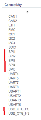

For example: STM32F429 has 5 SPIs and two USB interfaces: USB_OTG_FS (Full speed) and USB_OTG_HS (High speed):

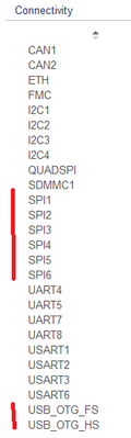

STM32F746 has 6xSPIs and two USB interfaces: USB_OTG_FS (Full speed) and USB_OTG_HS (High speed):
