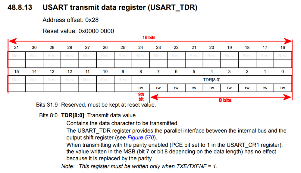

I read this but I fill data elements, the received data is lost
I fill the byte, I received all data
So this document is not clearly, Size must be 2*data element arry (u16) or 4*data element arry (u32), right?

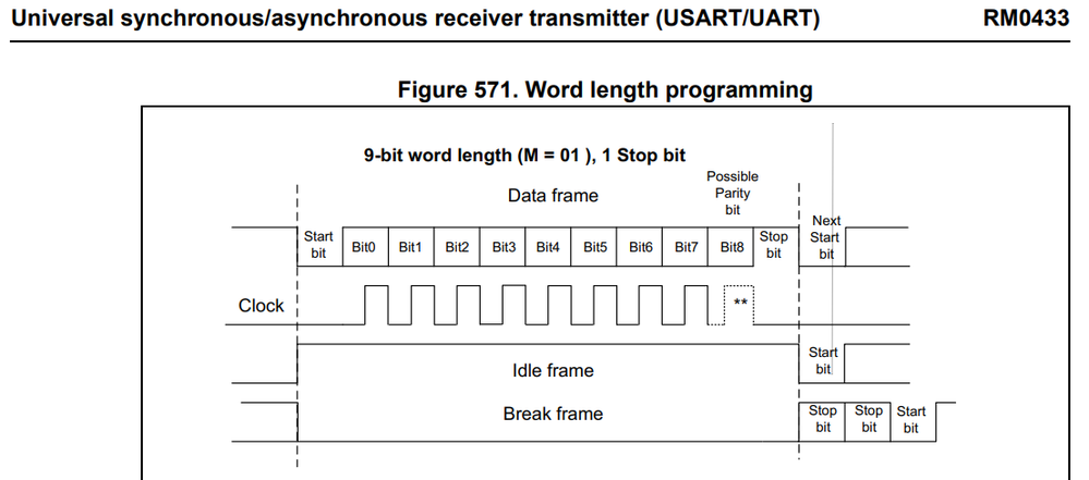

As it says, you use u16 when the UART frame's data payload size is larger than 8 bits - therefore can't be filled using a single u8 item.
So, if you are receiving complete data byte-by-byte, that means your data must fit in 8 bit payloads - so you should not be using a u16 buffer.
Show a minimal but complete complete example which illustrates your issue.
PS:
See also the device Reference Manual - see how the parity and extra data payload bits are handled...
My example:
uint16_t tx_data[7];
HAL_UART_Transmit_IT(&huart1, tx_data, 7);
or
HAL_UART_Transmit_IT(&huart1, tx_data, 14);
Which transmit command is correct?
that's not a complete example - is it?
As the documentation says, It depends on how you UART is configured - 8-bit (or smaller) data, or 9-bit data.
For 9-bit data, you need two buffer bytes for each transmitted UART Frame:
        |<-------------------------------------u16------------------------------------->|
Buffer: | -- : -- : -- : -- : -- : -- : -- : b8 | b7 : b6 : b5 : b4 : b3 : b2 : b1 : b0 |
PS - disclaimer: I don't know if that's the right bit/byte ordering - but you see how it takes two buffer bytes to contain the 9-bit payload?
