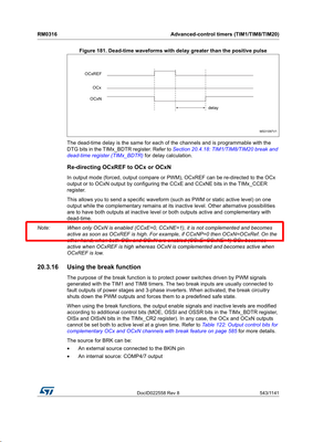

I am shutting down the output of the PWM signal (with HAL_TIM_PWM_Stop(&htim20, TIM_CHANNEL_2); , then this behavour is occuring). How can i just set the main output of the PWM to 0 but the complementary one should still switch?

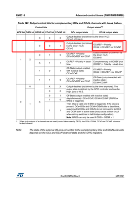

Change the given pin from AF to Output in respective GPIOx_MODER.
You could disable it by clearing respective TIMx_CCER.CCxE, but you'd also need to change the polarity of the complementary pin e.g. by flipping TIMx_CCER.CCxNP; and the result would be a threestated pin rather than actively pulled to 0 (unless TIMx_BDTR.OSSR is set).

The OCxRef signal is the output from the PWM generation unit. It is then split into two channels, one direct and one inverted. In other words, if you Force a level onto OCxRef, both outputs will stop, in mutually inverted state.
‎2019-02-13 12:43 AM
hmm ok thanks. So is there no way to force a output to just one channel without influencing the other one?
best regards, Benjamin.
‎2019-02-13 9:20 AM - edited ‎2024-07-17 11:05 PM
But I told you above, how to do it: the easiest way to do it is to change the pin you want to "force" from AF to output in GPIO (in GPIO_MODER register, and of course setting the required level in GPIO_ODR).
Another option is also to clear the respective enable bit in TIMx_CCER, but the fact that disabling the "straight" output changes the "complementary" output to "straight", may come as a surprise (not that it can't be handled by the polarity bits, but one has to be aware of this fact).
It's just the Forced mode in TIMx_CCMR.CCxM which can't be used for this purpose.
‎2019-02-13 10:25 PM
Thanks, I just cleared the TIM enable bit (Thats what I also tryed before) and also set the according polarity bit of the complementary output to 1. This worked :)
Best regards, Benjamin.

Jan, is the behavior that you describe, when disabling the regular channel makes the complementary channel output non-inverted, documented anywhere explicitly?
