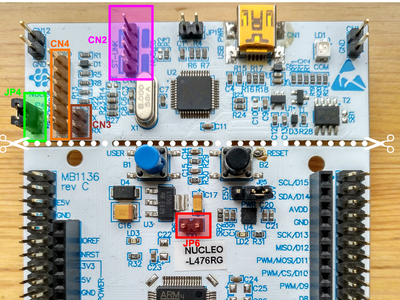

MM..1
Chief III
April 3, 2024
Any Nucleo 1. cut upper debuger and on your board only CN counterpart required.
MM1_0-1712160110595.pngBOOT0 isnt used with SWD, but  what other tools do I need to make the USB programming possible = CubeProgrammer sw
