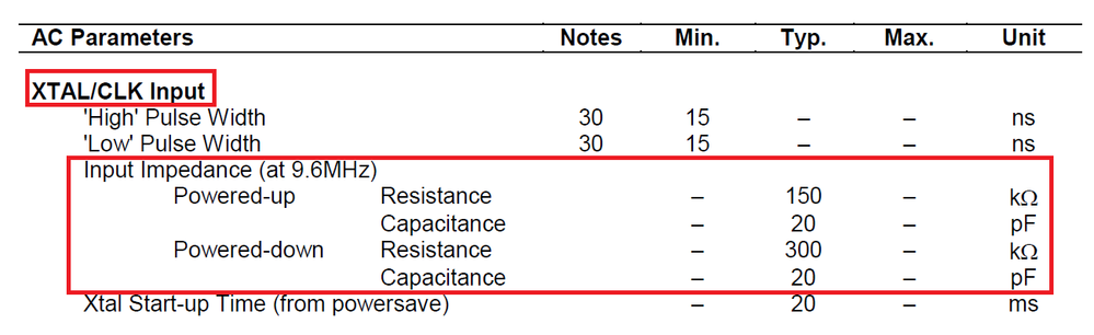

Hello all,
In my project, I'm using the STM32F411CEU6, with a 9.6MHz External TCXO as a clock source. I would like to use the same clock to feed another chip in the board.
I was thinking of using the MCO1 or 2 in order to rout out the 9.6MHz to the other chip.
The other chip XTAL input characteristics are:
Can MCO1 or 2 drive an input load of 150k / 20pF @ 9.6MHz?
Thank you all,
Chen

Posted on August 07, 2017 at 08:03
hello!
Yes it can drive the 9600 KHZ
At Datasheet @I/O AC characteristics,  and @Output voltage characteristics,   you can find it.

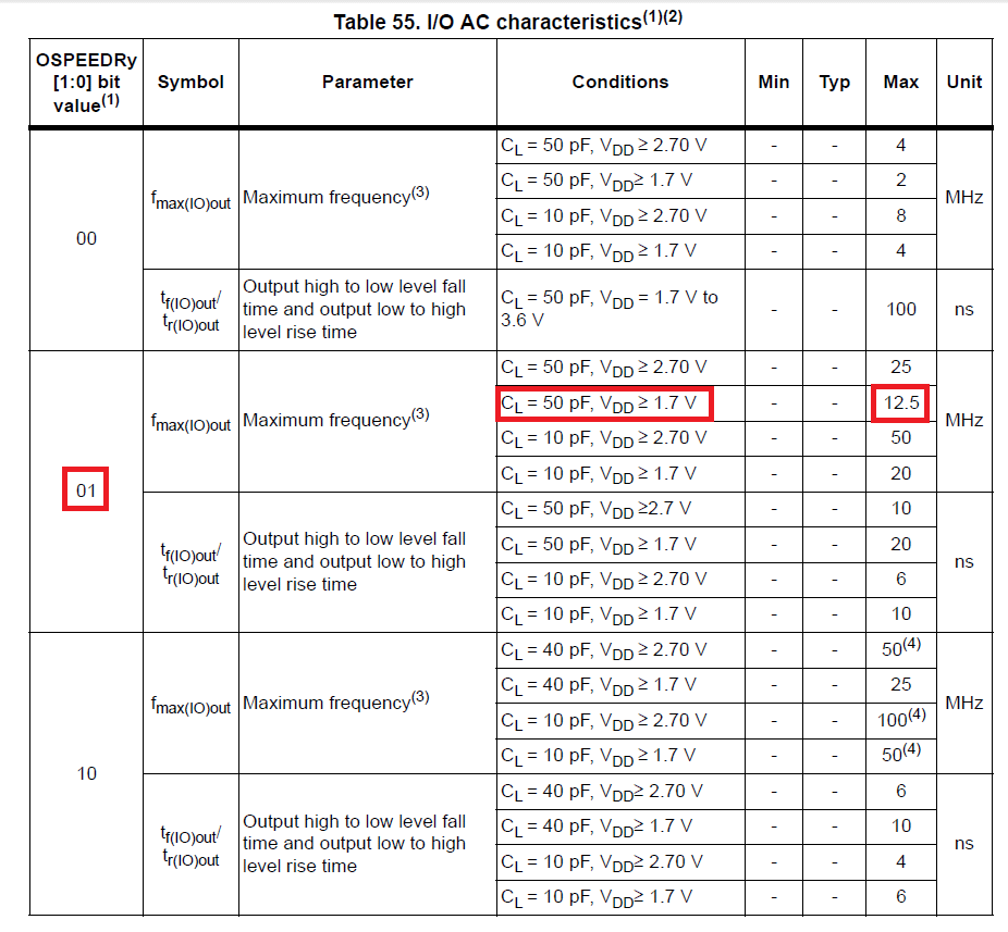

Posted on August 07, 2017 at 08:17
Hi Vangelis,
I did looked at the I/O AC characteristics table, but I wasn't sure that the I/O characteristics also refers to the MCO  characteristics.
Anyway, just to be sure...
If I use a 3.3V supply, and OSPEEDRy bits are ''01'', I can reach up to 12.5MHz under 50pF load?
Thanks again!
Chen
meir3
Posted on August 07, 2017 at 09:57
Great!  many thanks!
Chen

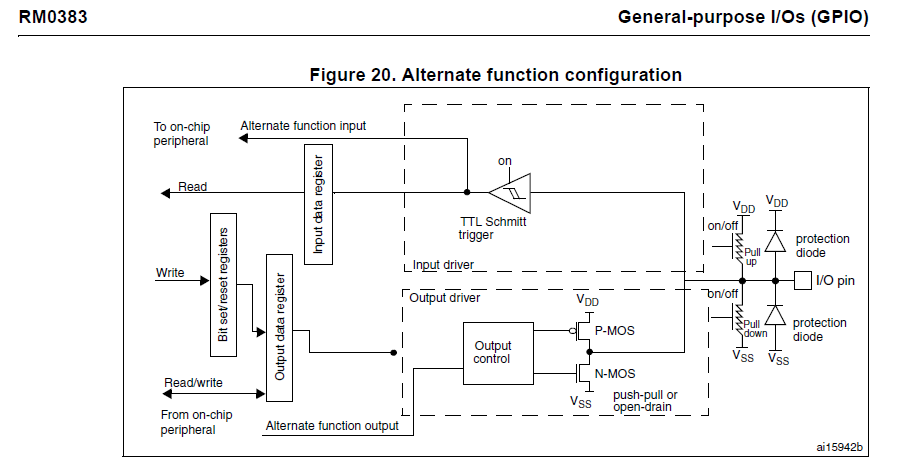

Posted on August 07, 2017 at 08:42
Hello again
For every GPIO pin (except otherwise specified) the output capability is not depend from internal circuitry but from output driver circuit.
At RM0383  @6.2.10 Clock-out capability, the mco functionality, is just an alternate output function of a GPIO pin.
