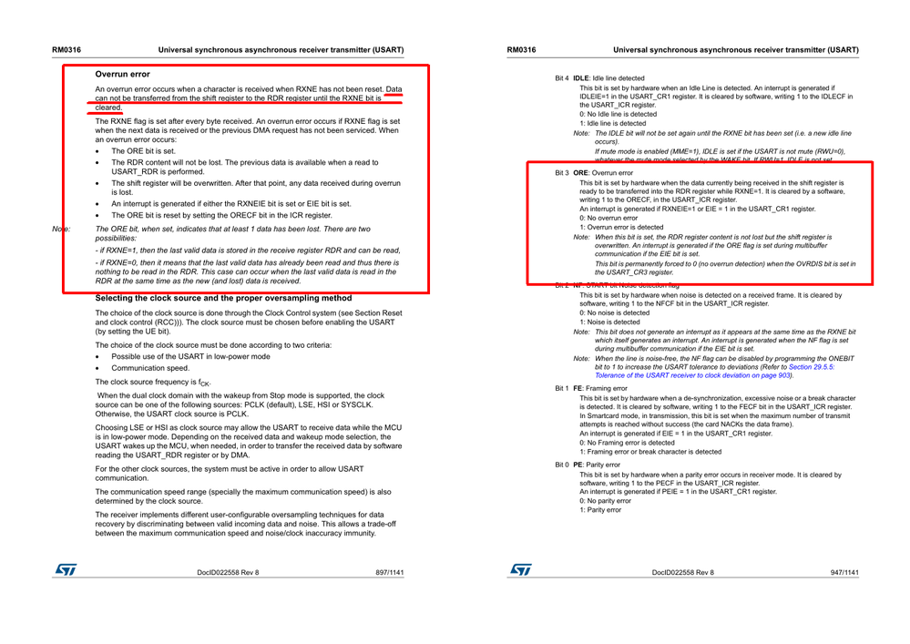

‎2023-01-02 5:16 AM
Watch for overrun condition. It can block reception.
‎2023-01-02 5:46 AM
Thanks.
How do I check that?
‎2023-01-02 9:10 AM
‎2023-01-02 10:56 AM
Overrun detection reports interrupt latency failure. Suggest to use LL low layer for uart communication to reduce WCET.

‎2023-01-02 2:54 PM
Besides of reducing overhead as @Johi​ mentioned, HAL_UART_Receive_IT(..., ..., 1) should be avoided. It disables the RX interrupt after receiving the requested number of bytes (1). This opens a time window until the interrupt is enabled again, and RX event can be lost or overrun can occur.
HAL_UART_Receive_IT( ... , x > 1) is only slightly better. If a received byte is lost because of line noise or framing errors, the requested number of bytes may be not received in expected time. It is unlikely but things happen.
I don't say to avoid HAL totally, but for UART you'll want to do so.
‎2023-01-02 7:06 PM
I concur. Assuming all application usart protocol to use known packet lenght before reception is already strinking out the universal console application. As previously said, LL for uart is preffered.
