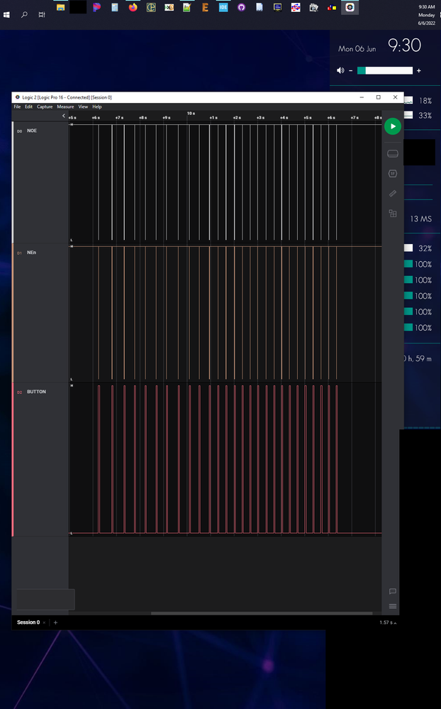

Hi, I have an FPGA connected to the STM32 (STM32F746IGT). The FPGA is set up to work as SRAM (tested and confirmed working). I’m using the STM’s Flexible Memory Controller to read from the ‘sram’. Now this works, but after 2 read cycles, the FMC stops attempting to read the ‘sram’. I have connected a logic analyzer to confirm, I was able to observe that the FMC dose not toggle any address lines or the enable pins after a few read cycles.
The FPAG is configured to have 12 address lines, 8 data lines, NEO & NE1. The ‘sram’ has no write functionality. The ‘sram’ is filled will data internally, and a ready signal gets toggled when the ‘sram’ is full, this signals the STM to read xyz data.
It almost looks as if the FMC reads the data form an address range, then assumes there is no data change, so it does not attempt to read anymore. Has anyone had experience with this? If this is in fact what the FMC is doing, is there a way to ‘reset’ the FMC?

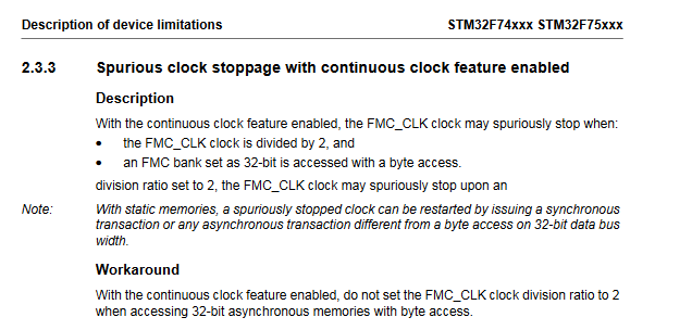

I checked the errata for that chip and found this.
0693W00000NrDw1QAF.png This sounds like the issue I'm having..... I suppose I'll not divide by 2?
Is there a way to manually start the FMC_CLK? or is it dependent on a transaction.
How exactly do you perform those "more than 2 read cycles"? Post code and related LA waveforms.
The erratum talks about "continuous clock". Do you have such feature enabled?
Read out and check/post FMC registers content.

During testing this morning, I have found that disabling d-cache stops the observable read failure. (full code and wave captures are attached)
Test 1, is the standard init governed by cubeMX.
Test 2, is the same code with D-cache disabled.
waclawek.jan
You can/should selectively disable caching for​ the SRAM area in MPU. In fact you should set it as Device.
