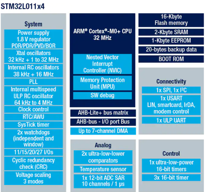

I'm looking for an mcu that can both do USB DFU programming and has and external crystal which there aren't many cheap available now (or would drop the external crystal requirements if I'd get convinced otherwise because I want it as stable as possible) for industrial application.
Now in STM32L011K4T6  datasheet page 13  there is a mention on crystal less USB operation, what does it mean? is there a way to somehow use USB to program this MCU without an st link?
also what should I be looking for  when checking if an stm32 supports connection of external crystal without bypass mode using 2 MCU pins like you normally expect? and how stable and reliable are the new crystal less MCUs that come out in comparison to old ones with externally connected crystals?

This means that some STM32s can maintain USB device mode clock by SOF signals from the host, without external oscillator. Details are in the reference manual. This does not warrant stability and precision of the clock to other components; just that the USB device will work properly from the host POV.

Copypaste error. I believe we've discussed exactly the same in the near past, maybe other 'L0x1 (USB is indicated by 2 or 3 as the last digit).

You miss somethink L011 dont have USB at all. About DFU read AN2606
