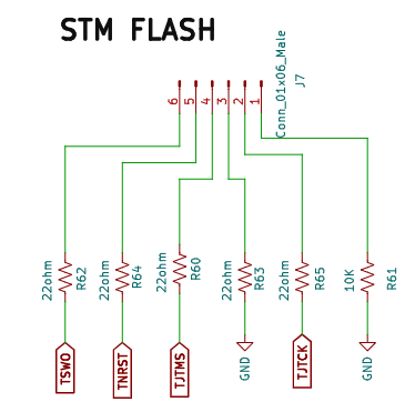

I have developed a custom board based on the MB997E evaluation board as a reference design.
1. Could you please help me review my custom board design and schematic to identify any possible mistakes.
2. In my custom design, I have also added an external 32.768 kHz crystal oscillator for the RTC function.
  • Is the connection correct?
  • Are the load capacitors and routing appropriate?
  • Do I need to make any changes to ensure stable operation?
I am attaching my schematic Any suggestions or corrections would be very helpful .

The schematic appears to be correct.

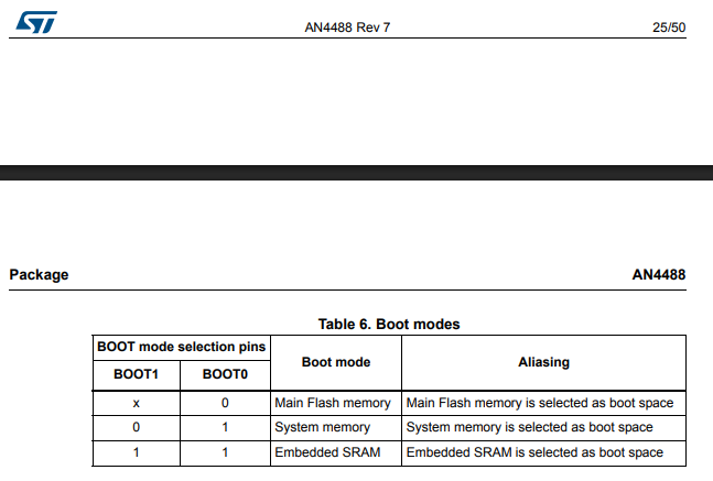

I recommend referring to the application note AN4488: Getting Started with STM32F4xxxx MCU Hardware Development for comprehensive guidance. You can access it here:
https://www.st.com/resource/en/application_note/an4488-getting-started-with-stm32f4xxxx-mcu-hardware-development-stmicroelectronics.pdf
This document provides valuable insights and best practices that will help ensure a robust hardware design for your STM32F4 series MCU.

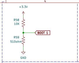

Why the divider?
(and similar on BOOT0)
You just need a pull-up or a pull-down.
Are you sure you want them both pulled high?
Just a style issue:
This could be better titled "SWD" and, as you're just using SWD, use the SWD names - rather than JTAG names

In addition, there is no 0.1µF capacitor on the NRST, as stated in the AN4488, section 3, mentioned by @NesrynELMK (the pull-up resistor that was common in MCUs of the last millennium is NOT necessary because there is already an internal pull-up).
