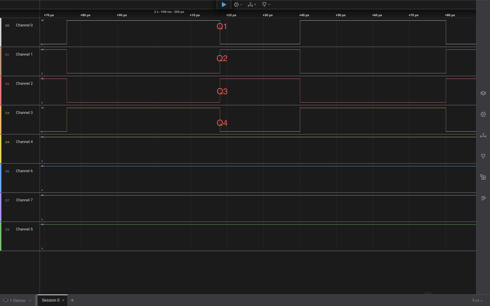

Drivinng ann H bridge to generate a sinewave , PWM generated and driving the H bridge .The PWM siganl as follows

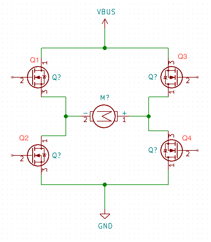

The H bridge Connection as shown below.
While appling supply the Low side MOSFET Q2 is Heating up Why so ?
I added some dead time also nothing happen .
I interchanged the H bridge PWM signal as functioning as Q2 siganl is properly changed to Q4 ,Now the Q4 is heating .

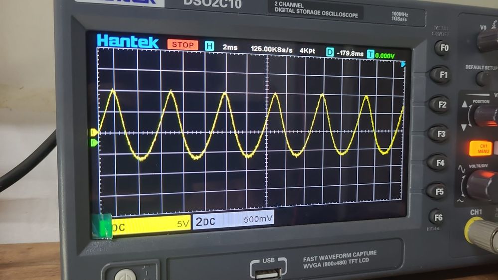

Also get a half sinewave shape little like a sharp peak like a triangle waves .
see the sinewave below
what wrong am doing ?

HAL_ADCEx_Calibration_Start(&hadc);
HAL_TIM_Base_Start_IT(&htim1);
HAL_TIM_PWM_Start_DMA(&htim1, TIM_CHANNEL_1, (uint32_t *)sin_table, 160);
HAL_TIMEx_PWMN_Start_IT(&htim1, TIM_CHANNEL_1);
HAL_TIM_PWM_Start_DMA(&htim1, TIM_CHANNEL_2, (uint32_t *)sin_table, 160);
HAL_TIMEx_PWMN_Start_IT(&htim1, TIM_CHANNEL_2);
HAL_ADC_Start_IT(&hadc);
