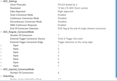

I am reading multiple ADC channels using Circular DMA and I have got a question that I want to clarify
On the STM32CubeMX, I have configured my ADC as following:
As you can see from above, I have Scan Conversion Mode and DMA Continuous Requests enabled. I have setup DMA in circular mode. I also use External Trigger Conversion Source as Timer 8 Trigger Out event and I have the Timer 8 running at 1Hz for testing purposes. I would like to clarify a few things.
I want to understand the relationship between Continuous Conversion Mode and External Trigger Conversion Source.
What is the point of having External Trigger Conversion Source (in my case TIM8) if the Continuous conversion Mode is enabled? Since the Continuous conversion ensures that another conversion is started immediately after the previous is finished, why would you ever need External Trigger Conversion Source.

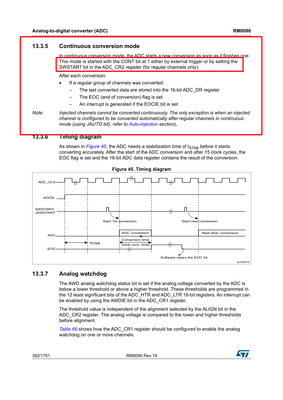

waclawek.jan
Which STM32? The ADC modules in different families differ significantly.
The answer, as always, lies in the Reference Manual, which you should have read first.
It means, that:
- setting ADC_CR2.CONT "tells" the ADC, that after one conversion finishes, automatically start a next one
- but it does not "tell" that "start a conversion now", so you need to start the first conversion somehow
- you've selected "external trigger", so the first conversion starts when the selected trigger arrives; subsequent conversions are started automatically, ignoring the trigger.
