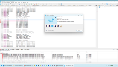

I normally use 1.19.0 because of the MX sillyness...
When compiling you get warnings - let's take stm32h723xx.h as an example.
Line 2516 is -
#define GPIOB ((GPIO_TypeDef *) GPIOB_BASE)
In 1.19.0 you get a warning -
Description Resource Path Location Type
(near initialization for 'output_port[9]') stm32h723xx.h /Cube-Wave-723/Drivers/CMSIS/Device/ST/STM32H7xx/Include line 2516 C/C++ Problem
In 2.1.1 you get an error -
initialization of 'long unsigned int' from 'GPIO_TypeDef *' makes integer from pointer without a cast [-Wint-conversion] stm32h723xx.h /Cube-Wave-723/Drivers/CMSIS/Device/ST/STM32H7xx/Include line 2516 C/C++ Problem
As it is actually your generated code I do wonder how this has slipped through your 'testing' process.
I was awaiting a news item reporting on ST employees being treated for burns as their ears caught fire after I found this ;)
Andy.

Please include more log lines and some source (C) lines. Where is that 'long unsigned int'  ? initialization for 'output_port[9]' ?
 Is this sufficient?
Pavel A.
This is a bit better. This shows that the error is in Core/code/src/numstr.c, lines 63 and 187 - but we still do not see these lines.  In any case the problem is not in stm32h723xx.h but in the .c file. Feel free to fix the errors.

These is also the same problem in num2str.c
I thought it would be easier to see in an ST originated file.
The same project when compied with 1.19.0 shows warnings.
When compiled with 2.1.1 it shows errors.
