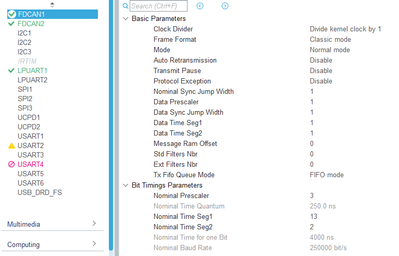

Here's my configuration for my STM32G0B1CBU6, in case there's something wrong with it (I checked on an oscilloscope and everything seems fine but maybe I'm wrong, also FDCAN1 and FDCAN2 have exactly the same parameters, I'm using both and both seems to send frames).

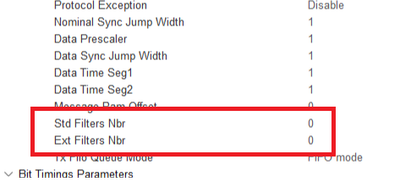

Which node is not receiving the CAN frame? from the title I understand that STM32F042G6U is having that issue,
But from your screenshot it seems you have an issue from STM32G0 side since both filter numbers are set to 0:
You need to set at least 1 filter to receive (standard or extended ID)!

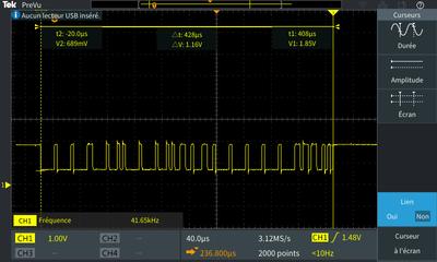

The node not receiving the can frame is the STM32F042G6U6
The node sending the can frame is the STM32G0B1CBU6. I send to you an oscilloscope screenshot proving it sends a Frame (a bit seems to be 4µs which is correct for a 250kb/s frequency i think ? that's why i supposed STM32F042G6U6 was the issue here)
