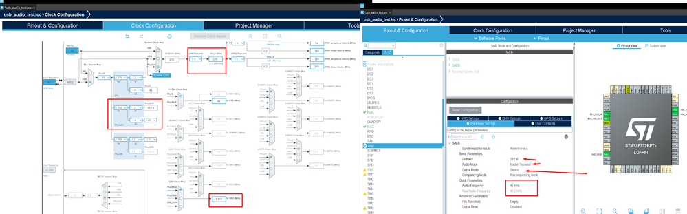

Hello, I have made my own STM32F732RET6 board that has a USB FS configured as a Stereo, 24 bit 48kHz Audio Interface and SAI2 connected to an SN75176BDR (Differential Bus Transceiver IC) because I want to transmit AES3-AES/EBU (same as SPDIF) audio data coming from the USB). So USB Audio -> SPDIF TX. Problem is I cannot get it to work right and ALWAYS get noise in the output signal (I have hardware that can receive AES3-AES/EBU so I can hear it). I am suspecting this is a clock issue where the frequency of the SPDIF signal is not high enough to support 24 bit stereo 48kHz, from what I've read, this would require an SPDIF frequency of 6.144MHz. I don't know if "Real Audio Frequency" in the .ioc "Pinout & Configuration" on SAI2 should match this number (6.144MHz) or the Audio Sampling Frequency (48kHz). I cannot get "Real Audio Frequency" to be exactly 6.144MHz. I don't know if this should be the frequency the the SAI2 Clock Mux outputs (SAI2 Clock Mux sources from PLLSAI1), I can get PLLSAI1 to output a frequency of 6.144MHz but then "Real Audio Frequency" becomes 96kHz (and when this happens I get no sound, no noise, absolutely nothing on the receiving end). When I get PLLSAI1 to output 192MHz, the signal I get contains some of the audio I sent from the computer (USB) but it is mostly noise. Is there any way that SAI2 works exactly on the frequency provided by PLLSAI1 (through the MUX) without a divider? I read an older post about CubeMX generating wrong Clock Config for SPDIF but I really cannot understand how he fixes it. He also mentions something about having to set the Audio Frequency to 96kHz in order to get working 48kHz but further than that I don't understand.

Below are both clock configurations, the first with the 3MHz Real Audio Frequency is the one the merely works. Second is the one with 48kHz Real Audio Frequency, matching the Audio Frequency which gives no audio.
192MHz Clock, 3MHz Real Audio Frequency192MHz Clock, 3MHz Real Audio Frequency3.072 Clock, 48kHz Real Audio Frequency3.072 Clock, 48kHz Real Audio Frequency

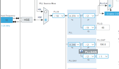

I used CubeMX inside CubeIDE to generate the code. The .ioc I have attached now is with the default generated clock for SAI2 which gives a Real Audio Frequency of 3MHz, SAI2 target settings are 48kHz Audio Frequency, 24bit, Stereo, I don't know what Real Audio Frequency should be. I have read an older post about the code generation using a MCLKDIV on SAI but I didn't really understand, I also read that in order to get proper 48kHz I have to set Audio Frequency to 96kHz. Anyway, in the .ioc I have attached I have set the SAI2 settings to how it should be working under ideal conditions.

While I’m not audio expert, I suggest you adjusting PLLSAIN to 246 instead of 240 ( PeriphClkInitStruct.PLLSAI.PLLSAIN = 246; in your code). This change should yield a clock frequency around 196.8 MHz, which can help generate a more accurate SPDIF bit clock close to 3.075 MHz.

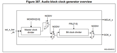

Hello, sorry for the later answer (I work in PA that why I need this kind of thing and was working those days). I did try that and it is noticeably better but still the problem persists. What happens with this clock now is some packets are played distorted while very few packets after a short period of time are played properly and this repeats. I cannot measure how often this happens but when I hear something (distorted) for a second or two, for a short moment it plays properly which indicates a clock problem because they are received in a wrong time. I have attached a .wav file which plays a song so you can listen the problem yourself (for reference the song is Tiesto - The Motto). On this post I see he feeds the SAI Clock with the a Frequency the Real Audio Frequency must be (feeding 3.072MHz to SAI, not a bigger value like in my case). I also read that he tells about problems with MCKDIV. What is MCKDIV? From what I understand it is a divider on SAI2 PLL that is not visible on the Clock Configuration windows. Can I make that MCKDIV 1 so that the clock I feed into SAI2 PLL is not divided?

Hi @nt2ds
About MKDIV, Master clock divider, bits are set and cleared by software (as part of SAI peripheral).  They have to be configured when the audio block is disabled
= 0000: Divides by 1 the master clock input;
You need to set NODIV=1 and leave MCKDIV = 0000 to feed the kernel clock input as it is.

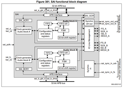

the whole block diagram:
