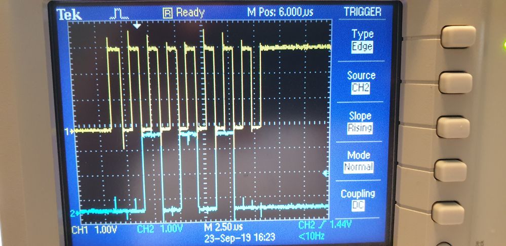

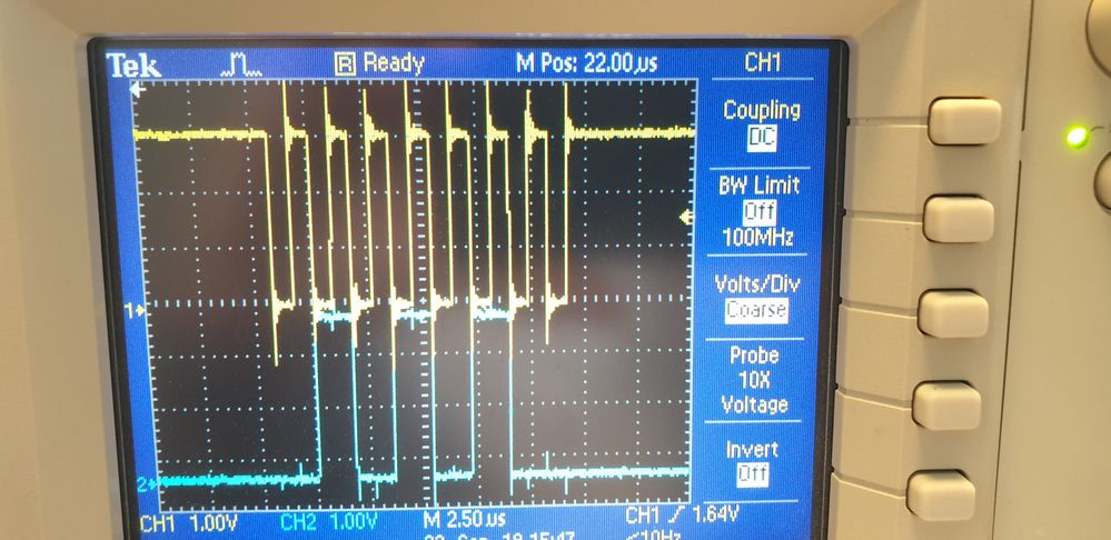

Ok so I found out that I had to access the DR in 8bit mode. That solved the extra clock cycles issue. Now I see another issue.
SCLK is not idling high even though I have set CPOL=1.
If I run a simple program from mbed and run on the hardware it is able to talk to the slave ADC just fine. The only difference between my implementation and the mbed program seems to be the clock.
Following is from my mbed program which is able to send command to adc and read back the reg. (sending 0x54=0b01010100 cmd)
Yellow is SPI clk, blue is MOSI
Pic below is from my own lowlevel SPI implementation
The master clk in second pic is not idling high. Can this explain why I am unable to talk to the slave using my SPI config?
‎2019-09-23 7:51 AM
So basically in the second case I was sending the SPI msg from master immediately after enabling SPI. After adding artificial delay , now both mbed and my implementation CLK/MOSI signals look the same.
Still no answer from the slave spi (works with mbed program). Now I am at a total loss. any one got any ideas?
