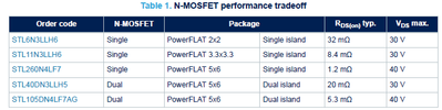

For Port 2, I recommend TCPP02-M18 because STM32G0B1 can manage 2 ports.
Key parameters of load switch selection are :
  • N-MOSFET
  • Voltage : at least 30V max (to secure if a plug on defective source provides 20V instead of 5V)
  • Rds-on : according to voltage drop and thermal losses at max current : 2A à 32mΩ x 2A = 0.064V acceptable and (32mΩ x 4A²) x 52°C/W = 6.7°C acceptable
  • Single MOSFET if SOURCE only / dual MOSFET if DRP not VBUS powered
Find below a list of possible ST N-MOSFET :
On STM32 example, D+ and D- lines are connected to STM32 data lines for illustration.
If you want to use another SoC, these lines need to be connected only to the SoC.
About SS lines, you can have a look on AN4871 where HSP051-4M10 (ESD only) and ECMF4-40A100N10 (ESD + CMF) are presented.
