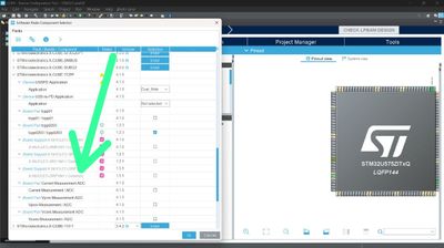

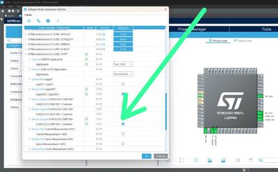

Subject: Issue with USB Data Transfer and Battery Charging on STM32U575ZI
We are working on implementing a dual-role USB Power Delivery (USBPD) setup with an internal battery. The system is designed so that when an external charger is connected to the STM32U575ZI, it charges the internal battery. However, when the STM32U083RC (external device) is connected to the same USB port, the STM32U575ZI provides power to the STM32U083RC. This is the expected behavior for our application.
**Hardware Setup:**
We are using the TCPP03-M20 USB Type-C Power Delivery protection IC for dual-role power application, as outlined in this [ST link](https://www.st.com/en/protections-and-emi-filters/tcpp03-m20.html?ecmp=tt9470_gl_link_feb2019&rt=db&id=DB4442).
For testing purposes, we are using the X-NUCLEO-DRP1M1 expansion board and following the steps from this [video tutorial](https://www.youtube.com/watch?v=mJ4VX_2B6wE), which uses the STM32G071RBT.
However, we have encountered two main issues:
1. **X-NUCLEO-DRP1M1 options not appearing in STM32CubeMX for STM32U575ZI:**
We are unable to enable the X-NUCLEO-DRP1M1 options in STM32CubeMX for STM32U575ZI, as shown in the video tutorial (see attached picture).
2. **DMA configuration not available for STM32U575ZI:**
While the DMA options are available and configurable when using STM32G071RBT, they do not appear for STM32U575ZI. We are unable to enable DMA options for Nucleo board STM32U575ZI, as shown in the picture.
NOTE- same we tried with custom PCB we are getting same result.
Could you please advise on how to configure the X-NUCLEO-DRP1M1 and enable DMA on Nucleo board STM32U575ZI?

Dear NajeemSyed
X-NUCLEO-DRP1M1 are in Nucleo-64 form factor so it is dedicated to be plugged directly on a NUCLEO-G0xx or G4xx.
this is ony in this case that you can use the X-NUCLEO-DRP1M1 BSP.
Then in your case, you have to define required resources :
- I2C
- GPIO Out for Enable
- EXTI for FLAG
- At least 1 ADC Channel for Vbus
And in the X-Cube-TCPP software pack, "Platform settings" affect these resources to the application requirements.
The video is using STM32G0xx MCU in its example. This MCU is using DMA,
For STM32U5 go to the GPDMA page.
Best regards
Pascal

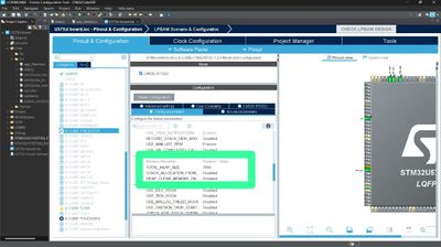

Hi Pascal,
As per your guidance, we are using the Azure RTOS Dual Role code to test the Dual Role functionality on the U575ZI board.
- Based on our previous conversation, I downloaded the `U5_DRP_Cube.ioc` file and used it as a reference (after converting it to U575ZI since the attached IOC is for U585) to implement Dual Role on the U575ZI. However, after uploading the generated code, the DRP1M1 board does not function as a Dual Role device and does not show as a COM device in the UCPD monitor.
- I have attached the `U575ZI_DRP_Cube.ioc` file, which has been modified for the U575ZI board, for your reference.
- I noticed that in the `U5_DRP_Cube.ioc` file, only ThreadX and USBPD are enabled under the Middleware tab, but X-TCPP is not enabled.
- Additionally, I could not enable USART1 at 921600 baud rate, so I configured LPUART1 at 921600 on the U575ZI.
Please review the attached IOC file and guide us on how to implement the Dual Role functionality.
Please let me know once you have a solution for the X-CUBE-FREERTOS issue on USBPD applications for STM32U575.
Note:For our learning purpose, we connected the X-NUCLEO-DRP1M1 board to an STM32G0 board and successfully implemented the PD Dual Role functionality, which worked perfectly.

Dec 9, 2024 9:15 AM UTC
Hi Rajkumar24
I made some changes in your .ioc.
- I configure USART1 which is the one connected to the STLINK.
- I enabled "CAD Role Toggle" in the USBPD Middleware configuration
- I enabled X-cube-TCPP middleware, (may be disabled during the migration).
Let me know if it works well.
Best regards
Pascal

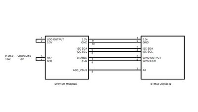

Dec 12, 2024 6:50 PM UTC
Hi Pascal,
Thank you for the IOC file.it’s working perfectly with FreeRTOS. I have attached a video for your reference. Once again thank you.
As mentioned earlier, our final product includes power delivery, data transfer (USB CDC host), and code flashing via USB instead of ST-Link.
Initially, we tested only with the Nucleo U575 board, and both USB flashing and USB CDC host functionality were working fine.
(Note-Code flash via usb- Just connect ph0 pin to ground and put power via USB port instead of stm32,Instead of st link)
1. after adding the X-Nucleo Drp1m1 board to the Nucleo U575 board and following the same pin connection as you mentioned earlier and we added the D+ and D- pins with jumper wires.data transfer and code flashing are not working. Could you please guide me if there is any hardware connection Or any usbpd configuration we might have missed?
2. could you confirm if the battery on the X-Nucleo board needs to be connected to the sink (screw terminal) for charging?
Looking forward to your guidance.
Best regards,
Rajkumar
PPAIL.1
Dec 13, 2024 7:07 AM UTC
Hi Rajkumar24
Thank you for your video ! Happy to read that your application is working.well.
1- I suppose you connected D+/D- from X-NUCLEO-DRP1M1 CN10-12 and CN10-1.
If yes, this is correct, R19 and R20 are present.
The difficulty I see is that using free wires we don't respect anymore the 90Ohms differential pair.
2- I confirm, the battery charge has to be managed from the X-Nucleo-DRP1M1 sink (screw terminal).
Here is an application block diagram:
Best regards
Pascal
