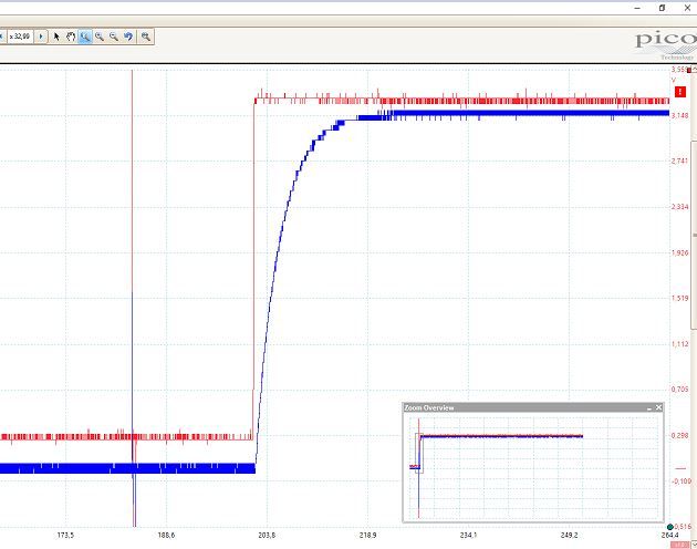

Hi guys,
I'm using the
STM32L475RCT
 in a custom board. When using the JLink everything is working fine but when I discounnect the Jlink and power cycle the board the application doesn't work at all. Each time I have to force NRST to 0 and release it in ordre to make the application works.
I have 100nF capacitor between the NRST pin and GND as recommended in ST  datasheet(
6.3.15
I checked the voltage on the NRST pin and it seems correct : it goes from 0.358V to 3.1V  in ~4ms at board power up which follow the required low level voltage ( VIL(NRST)  =0.3?VDDIOx = 0.984V) and high level reset voltage  ( VIH(NRST) = 0.7?VDDIOx = 2.29V).
Any thoughts on where the problem might be ?

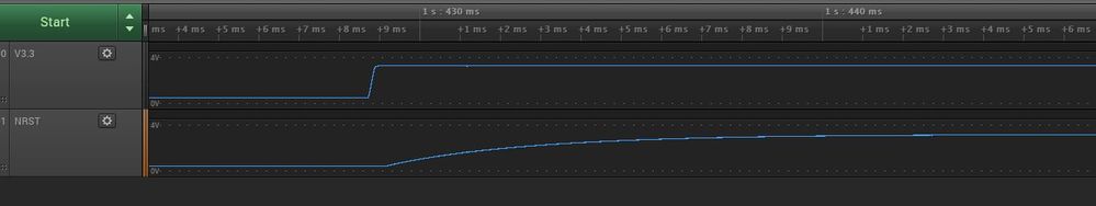

Guys, I figured out.
I connected the BOOT0 to GND and the standalone application started working without the JLINK.
Not sure the reason of this since in the manual leaving BOOT0 NC won't have an effect on the startup sequence ! I think I'll need to do more reading on this subject.

Posted on April 30, 2018 at 14:31
I would look at what you are doing with the supply pins, especially VDDA, and if you have multiple supplies. Check initial rise times on a scope with respect to NRST.
Consider using a POR chip like the MCP120 to threshold on the slowest supply.
Posted on April 30, 2018 at 15:20
Thank you for your response,
I have a single 3.3V powering all the VDD and VDDA pins with 100nF capacitor for each pin.
I forget to mention that I checked both the V3.3 and NRST rise time and they were fine. here is a screenshot
I have the same circuit working with no issues on the STM32F417 !

I have tried 10K pull up on the NRST and connecting the BOOT0 to GND (I do that on other boards) and still getting the same behavior!
Wonder If a delay between the rising of the V3.3 and NRST is necessary ? I doubled checked the curves and got the below figure :
Blue : NRST
red : 3.3V
When I force the NRST to 0 and turn on the power supply and just after I release manually  the NRST pin, the application run right away!
