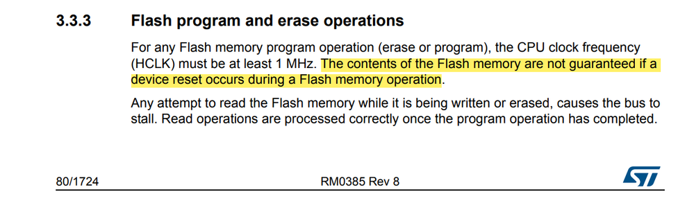

2023-06-05 5:03 AM - edited 2023-11-20 4:06 AM
Dear @kamil Duljas
Here it is in STM32F7 Reference Manual
It would be interesting to read the content of the RDP byte and see its value : 0x00 , 0xFF or any other value in your case. Hope it helps you
