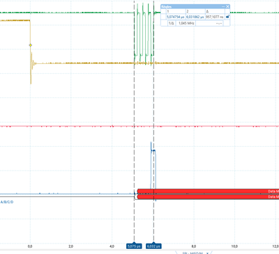

I'm using trying to access to an external flash through the SPI
I try to send 5 bytes, my SPI transmit function work well if I put some delay (1us) between each byte, if I don't put this delay transmission start and stop just after 4bits.
green -> clk
yellow -> cs
blue Mosi

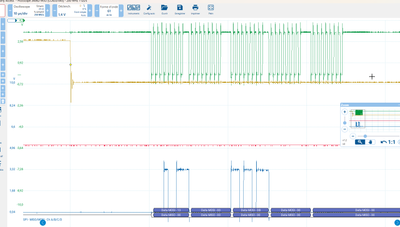

same code with delay activated

 // Wait some time before continuing why???? without that is not working, normally SPI_FLAG_TXP should take care of availablity of space
 uint32_t au32_ticks = DWT->CYCCNT + 500;
 		while (DWT->CYCCNT < au32_ticks);

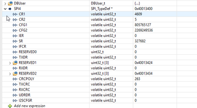

And register content before transmission loop
When delay is not there, I have the impress that uploading second byte interfere and cancel the transmission that is on going.  Adding the delay fix this but I don't understand where is the mistake, for me no delay is needed SPI_FLAG_TXP is there for that.

My code is largely inspired from the HAL_SPI_Transmit(). If I replace my function by a call to HAL_SPI_Transmit() I don't have the problem, it's also based on the TXP_FLAG.
I compared registry content for both function before starting transmission and they are stricly the same, (FTHLV set to 1data)
Thank-you

I did the same test with both function my and HAL, content of SPI register just before the transfer loop are equals.

Apr 17, 2025 9:25 AM UTC
Executing code from flash, send 8bits in place of 4, pushing the second byte into the TXDR seems to cancel the ongoing transmission
