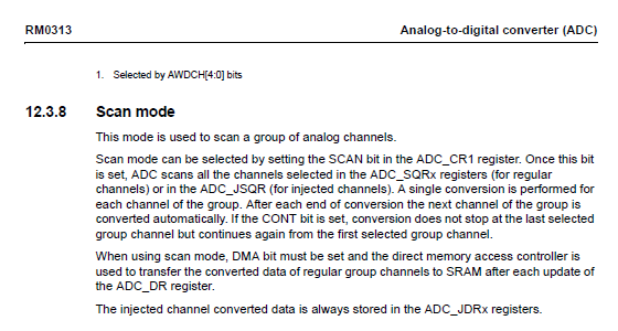

Are you saying that SCAN mode is not to be used for a regular group conversion? Because if so, how does the ADC know to convert a group? Here is what the reference manual says:
‎2015-03-12 11:10 AM
Making the change on the timer trigger configuration fixes the single-shot issue!
No problem, but I have stripped you of your IC Validation merit badge.Are you saying that SCAN mode is not to be used for a regular group conversion? Because if so, how does the ADC know to convert a group?You have a ''group'' with ONE member, I'd advise you not to scan it. If you have more than one channel, then yes scan them.Up vote any posts that you find helpful, it shows what's working..
‎2015-03-12 11:45 AM
Sure - that's fine. This was a hold over from copy pasting code and deleting what wasn't necessary to generate a stripped down example that works.
But the SCAN bit is still. . . unclear. Reading that, I can see a couple interpretations:1. Setting the SCAN bit will trigger a conversion of a group once. If I read the bit, it will read back 1, but if I ''set'' the bit again, it will trigger another conversion of that group, also once.2. In order to convert a group, one must set the SCAN bit, then trigger conversions some other way.You're correct to take away my IC Validation merit badge. I need to spend more time exhaustively experimenting with all possible meanings of the RM text before I declare the chip as defective.- Mark as New
