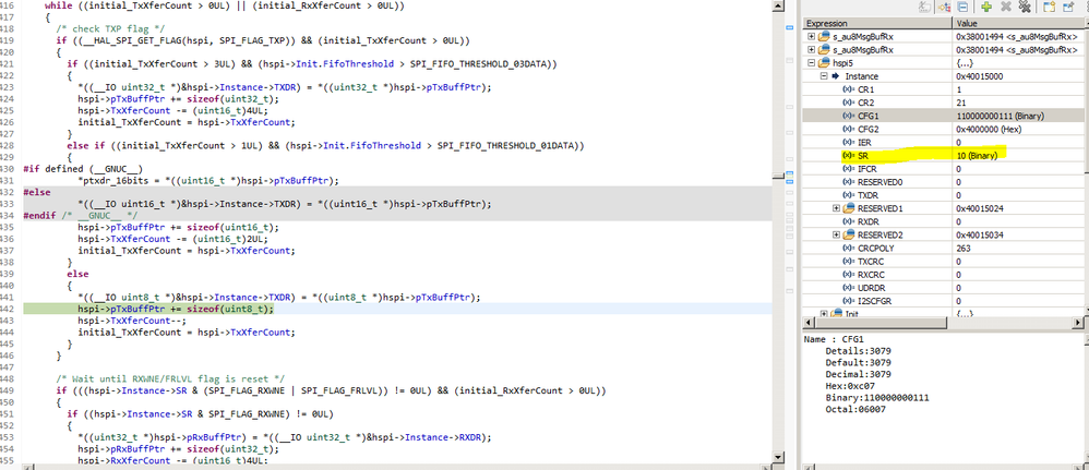

Problem:
When following line of code is executed
*((__IO uint8_t *)&hspi->Instance->TXDR) = *((uint8_t *)hspi->pTxBuffPtr);
i am expecting the TXP flag to get reset, but it get reset only when i execute above line of code 8 times, but my FIFO is set to one.
Following is the screenshot of debug window
0693W00000GVnz9QAD.pngWhat is missing, am i doing something wrong.
just for the information initial_RxXferCount is not decrementing that means indeed the master is not clocking. Also if i write manually some data in TXDR register through expression window during Debug then TXP flags get reset (as expected)
Please let me know if you need more information.

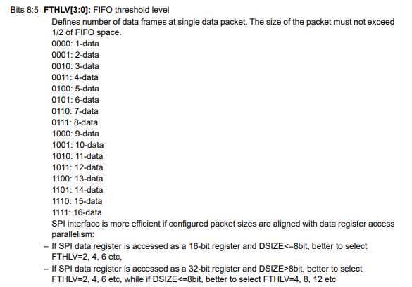

Per the RM:
TXP flag is cleared when the
TxFIFO contains less than
FTHLV empty locations
Since it can hold 8 bytes, and if you have FTHLV = 1 byte, it takes 8 writes to fill it up and reset the flag.
Edit: might be wrong about the exact size of the TXFIFO, but the concept is correct--it takes more than one write for the free space in the FIFO to drop below the threshold.
DGupt
Many Thanks For your answer,
Following is my config so it is not 8 bytes, it is 1 data which should correspond to 1 byte
It should take two writes to clear the TXP flag, During first write, the data will be written to fifo and immediately gets transferred to SPI transmit register making the FIFO empty, During second write the data will remain in the FIFO as it cannot transfer the data to SPI transmit register (as it is holding the old data during first write.).
During Second write TXP flag should get reset, but it is not. As i mentioned TXP is becoming zero if you write two time in TXDR register through expression window during debug.
Any clue why?
Thanks again
Best wishes
I don't believe the Reference Manual supports this claim. That is how it would work on the STM32F4, but the STM32H7 SPI does not function the same as older/simpler families.
Presumably, writing through the debug window is a 32-bit access, not an 8-bit access.
DGupt
Thanks, you are absolutely right,
