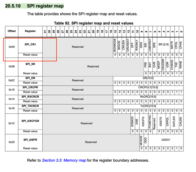

SPI Register CR2 Missing on Register Map RM for STM32F411RET6 (RM0383 Rev 3)
anardinelli
SPI CR2 is missing from RM (RM0383 Rev 3) table in 20.5.10 SPI register map (page 610). Please update.
Best,
Alessandro

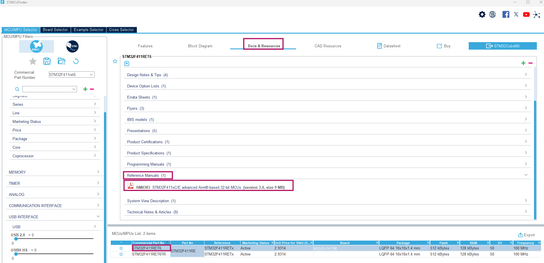

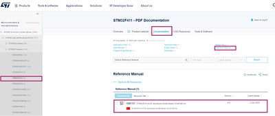

Hello @anardinelli;
Thank you for updating post and for issue clarification.
Could you please precise which STMCUFinder version are you using?
With STMCUFinder 6.1.0 version for windows, I can see that the integrated version of RM0383 is version 3.0.
I will report this issue internally.
But when clicking on RM0383 to download the reference manual using STMCUFinder, I find that the RM0383 Rev4 is downloaded, because STMCUFinder redirects to STweb site.
I advise you to download the product documents from ST web site.
Thanks and best regards,
Kaouthar

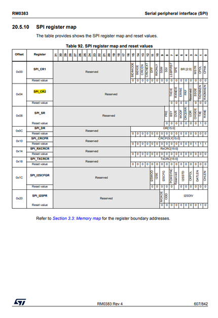

KDJEM.1
Hello @anardinelli,;
This issue is fixed in RM0383 rev4.
Could you please refer to the latest reference manual version RM0383 Rev 4.
Thank you for your contribution in STCommunity.
Kaouthar
