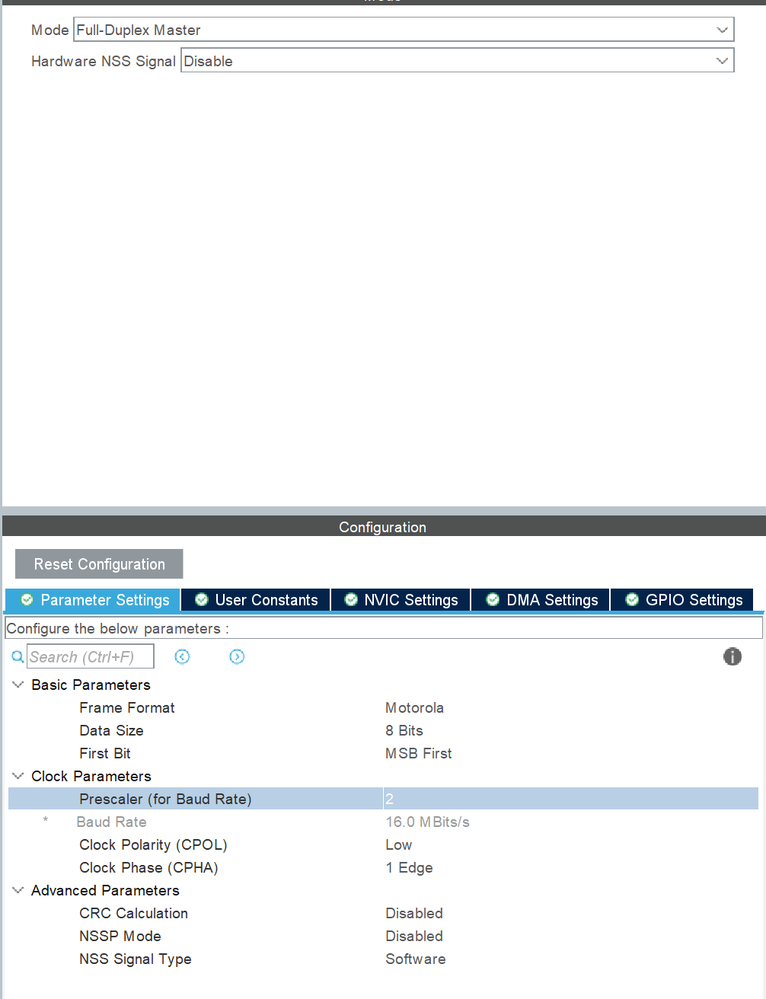

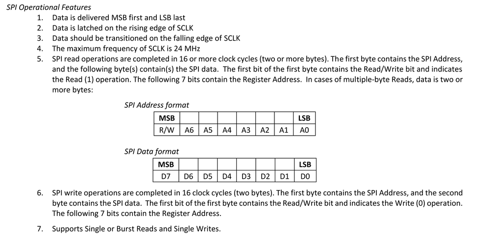

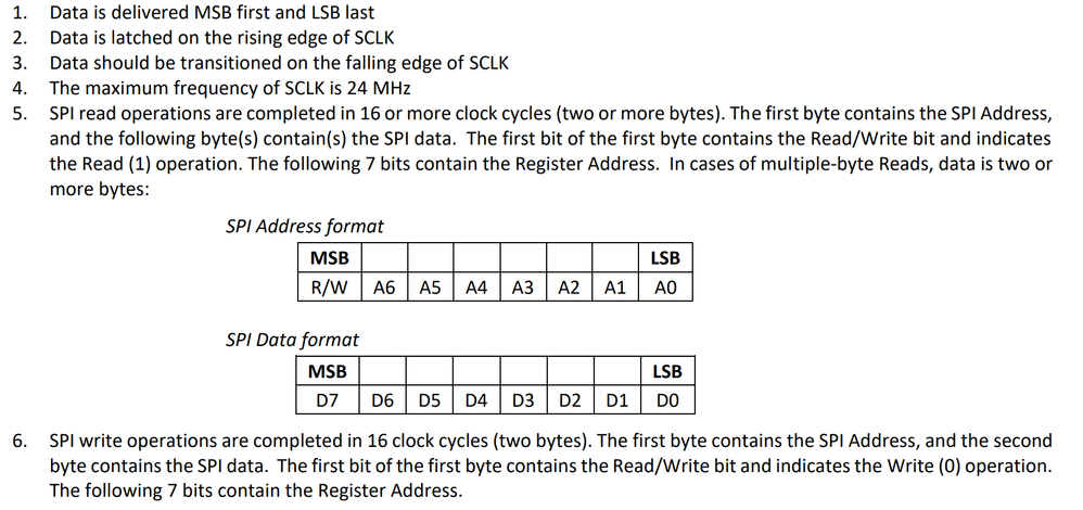

I'm trying to communicate with a slave device (ICM-42688-P: https://invensense.tdk.com/wp-content/uploads/2020/04/ds-000347_icm-42688-p-datasheet.pdf), but I don't recieve anything on the MISO line. I'm using the nucleo-wb55rg for the master device. The ICM-42688 typically needs 1.8V for the VDD and VDDIO, but the datasheet says it can be used between the range of 1.71V and 3.6V. Therefore I just used the nucleo's 3.3V pin output to power both. After that I configured the SPI following the datasheet:
The code I wrote for excercise is a read from the whoAmI register, which is at address 0x75 and contains the value of 0x47. However I only get 0s from the MISO line.

What am I missing here? Did I messed up something in the code or it is more likely a hardver issue?
I am looking forward for your answers!

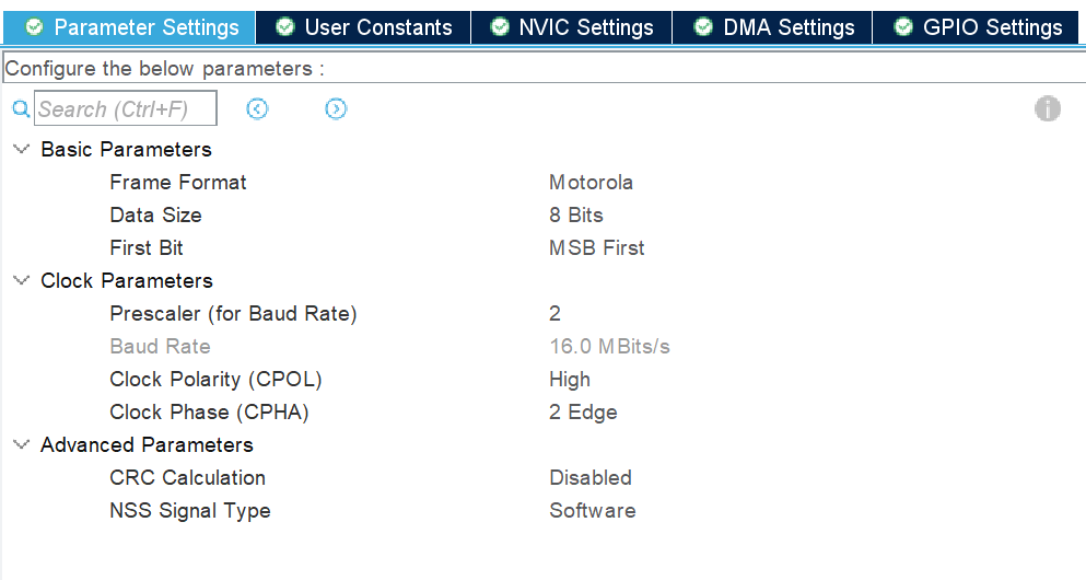

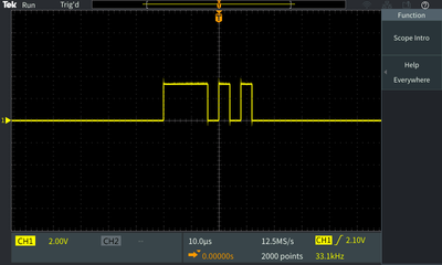

I tried out your suggestion and it worked (on both cpol low & cpha 1 and cpol high & cpha 2). Now I can see data on the MISO line on the oscilloscope and the debugger. However I read on the MISO line 0x40 in spite of the WhoAmI register should contain 0x47. Do you have and idea where that 0x07 goes?
‎2024-04-17 3:58 AM
@AndrasToth wrote:I read on the MISO line 0x40 in
Is that the value you see on your scope, or the value you receive in your software?
‎2024-04-17 4:05 AM
I read the 0x40 in the software and I can see the following on the oscilloscope:

I configured it as you suggested (cpol high & cpha 2) using STM32CubeIde 1.13.2, but I can't find in the advanced parameters the Master keep IO state option.
Which .c file do I have to write a code that can manually enable this setting?

I am not sure about - WB55 cpu i dont have (and i cannot look here - i am at work),
but most SPI have this setting : in Advanced parameters (in Cube) you should see it (or this SPI dont have it , then also ok.)
Its just : to keep the spi lines at its active state, between transmissions etc. , to avoid target "see" a extra pulse.
If you dont see this setting , its ok. (Then this spi should do it anyway.)

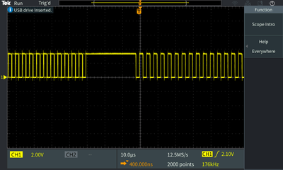

@AndrasToth wrote:I can see the following on the oscilloscope:
What's that looking at?! :flushed_face:
You need to look at the full SPI transaction - is the slave actually sending 0x40, or 0x47, or ... ?
Also, does what your STM32 actually sends on the wires match the slave specs?
Does your scope have the capability to decode SPI?
Surely, a Tektronix scope has a way to capture a proper screenshot?
It was the reply on MISO line to the read command, but I'll capture a better one.
I did and that was the only signal.
Yes it should be. The first bit of the first byte declare that the command will be a read(1) or write(0) command and next 7 bit is the address, which for the WhoAmI is 0x75.

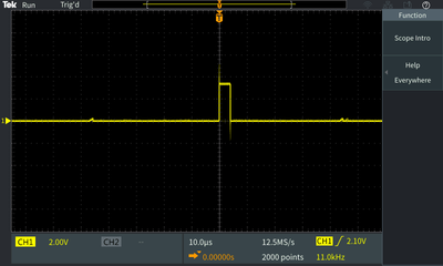

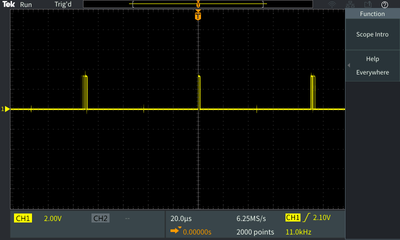

It can't unfortunately, I can only look at it deciper the signal myself.
The following pictures from the oscilloscope:
CLK:
CS:
MOSI ( 0x75 | 0x80 is 0b11110101 and I think this signal is exactly the same):
MISO:
