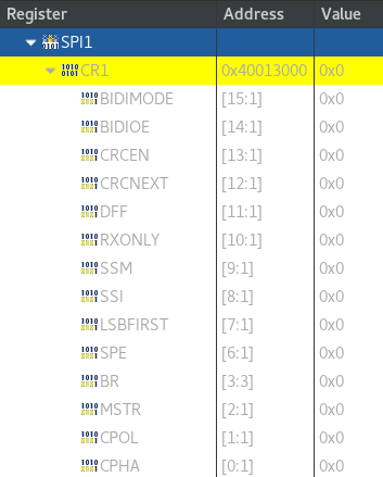

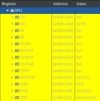

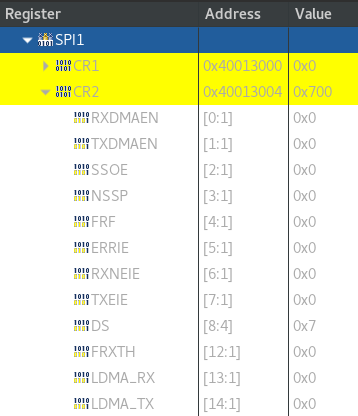

Fabian21
Here are the registers after initialization. Looks fine to me.
Edit: Ohh sorry, that was just the initialization, before enabling it. This will also set the SPE bit in CR1, everything else stays the same.
