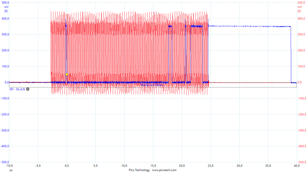

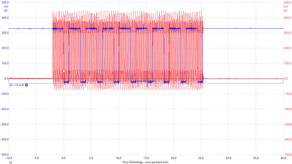

KR51K
Ok, another thing I noticed: if I watch the MISO signal with the scope, everything is ok. But when I pause the debugger, I see this 'strange' data pattern on the MISO line. So what I could imagine is that the slave has an error with the HAL_SPI_TransmitReceive_DMA function at one point during the runtime and does not recover. So, anyone an idea what the correct behaviour is, if you get a a status != HAL_NOK from HAL_SPI_TransmitReceive_DMA?
KR51K
Normal behaviour
Behaviour during debugger paused:
waclawek.jan
We still know nothing about your application.
If slave receives clocks and there is nothing which would write to the SPI transmit register (e.g. because the program which normally writes to it is stopped by debugger), it keeps repeatedly transmitting the last frame.
