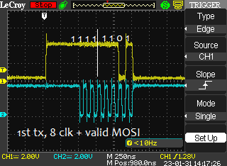

I´m using the SPI1 via the alternative pins PB3-PB5 and I'm experiencing various issues. I have previously used the STM32F722 with somehow same CubeIDE setup and code and that works perfectly.
I have made a simple test application that only sends one byte via. HAL_SPI_Transmit.
When setting a high baud rate (20M) it seems to work ok. This is too high for my design and baud rate is lowered. When monitoring the SPI clk. not all clk. cycles are transmitted. Lowering the baud rate even more results in no clk. cycles being transmitted.

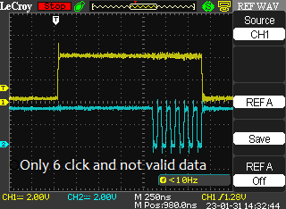

I think I have a solution. Adding a timeout to the "HAL_SPI_Transmit" did the trick.
  • even though this was not necessary with previous MCU model??

My test code is like below:
In main I try to send same data value via SPI1 multiple times
DisplayDriver_Write_Command(0xFD);
void DisplayDriver_Write_Command(byte command) {
HAL_SPI_Transmit(&hspi1, &command, 1, 0);
while (HAL_SPI_GetState(&hspi1) != HAL_SPI_STATE_READY);
1st tx of 0xFD is ok (see picture)
2nd tx of 0xFD is not (see picture)
