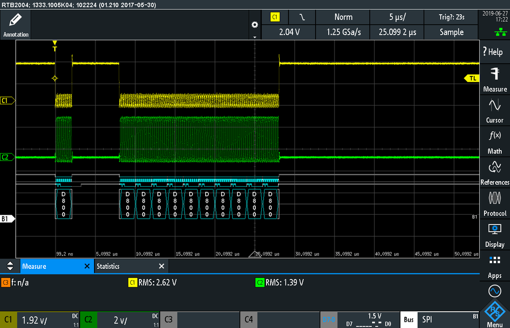

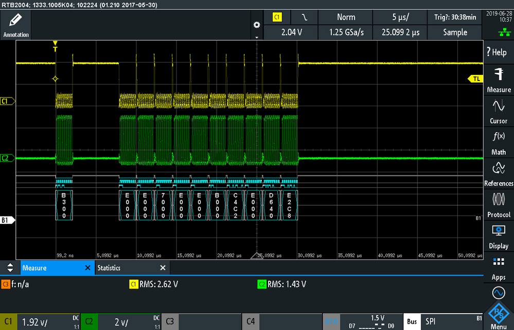

next picture shows the required behavior as it runs on STM32H743
next picture shows what happen without pulsating NSS
there's no time between bytes to intorduce NSS pulse manually using timer or GPIO
The only solution which I have now is using SW NSS and send SPI data byte by byte -No DMA and no Bursts- but the problems is that it's much s;lower and the overhead on controller as shown in next picture
