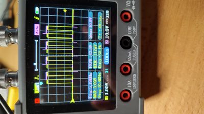

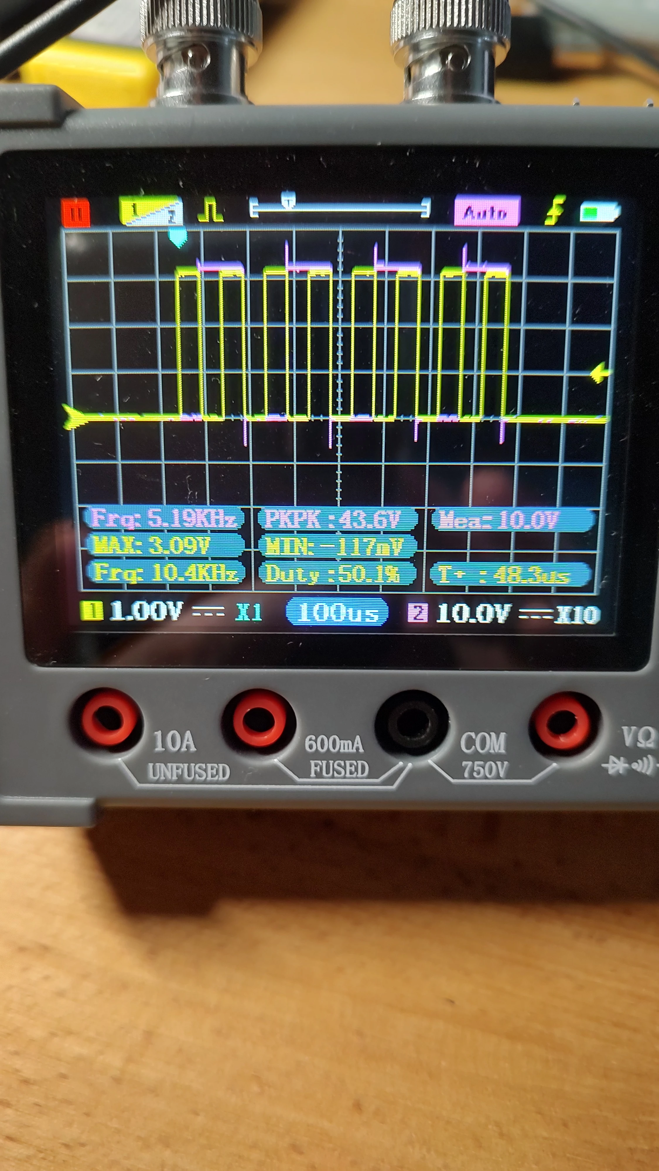

The thing is, the 7-segment displays almost always random ***. I measured every signal with oscilloscope.

Thanks for the hint. I think it's any hardware issue. The scope looks good:
Edit:
The problem was that I swapped RCLK and SRCLK pins. I hate the data sheet, the description says
RCLK 12 14 I RCLK Input
SRCLK 11 14 I SRCLK Input
Man, this is not very helpful actually 8-(
Edit:
