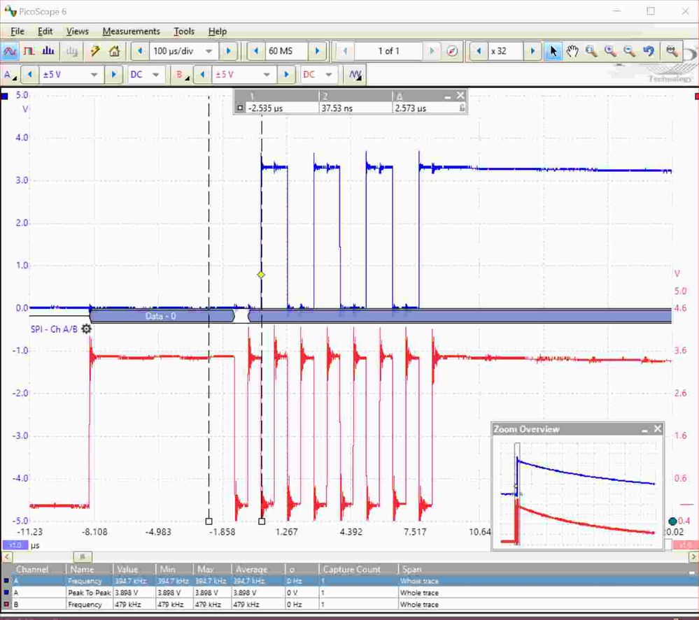

SPI clock issue in modes 2 and 3: H743
Peter Mather
The clock and data lines on SPI seem to go tri-state off when not in use even though the SPI channel is left open. Is this expected behaviour? It causes issues with some connected chips as they see the re-establishment of the driven clock signal as a clock pulse
Code is:
HAL_SPI_TransmitReceive(&hspi3, mybufft.cTxBuffer, mybuffr.cRxBuffer, 1, 5000);

see
void MX_SPI1_Init(void)
 hspi1.Init.MasterKeepIOState = SPI_MASTER_KEEP_IO_STATE_ENABLE;

> Code is:
That's no code. That's a call to a "library" function. Look at that what it does.
Or use bandaid a pullup.
