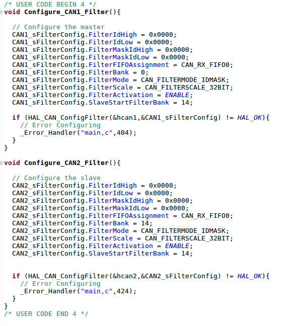

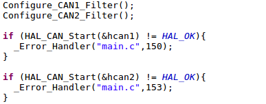

Hey I was hoping that the STM community could help me with a problem that I have been stuck on while developing a CAN bus application. I have a STM32F746ZGT6 micro controller on a custom PCB with two isolated CAN transceivers, ADM3054. My setup is as follows:
- STM32F746ZGT6 MCU
- Configured with CUBEMx
- Debugged in STM Workbench
- FreeRTOS
- STM HAL driver suite
The problem is that I cannot get both CAN channels working together to pass messages back and forth across two CAN busses operating at 125 KHz. I have confirmed that my transceivers can successfully operate and receive and transmit independently when performing forced, hard coded transmissions, but when I try to apply the system as a CAN bus pass through, things break.
My main suspect for the issue is with CAN transmission, somewhere in between the driver (stm32f7xx_hal_can.c/.h) driver and the transmit lines leading to the ADM3054. Here is my code:0690X000008j4W7QAI.png0690X000008j4W2QAI.png0690X000008j4VxQAI.pngIn the next picture is where the code is getting stuck, the while loop that checks for a free mailbox never exits.0690X000008j4VsQAI.png

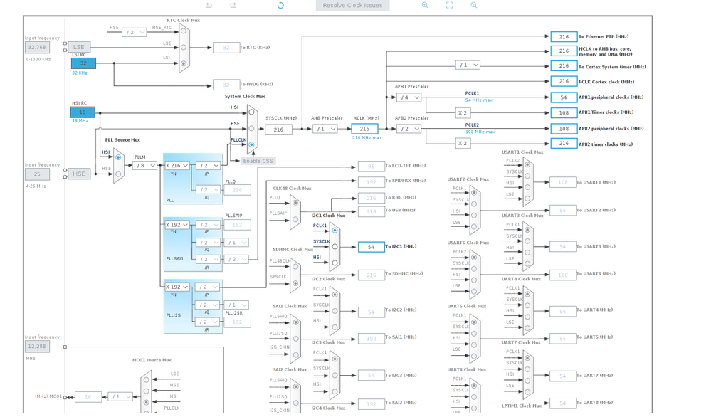

This is my Clock Config:
When in debug mode and connected to two active CAN busses, one terminating into CAN 1 and the other into CAN 2, I can confirm that I can receive messages from both busses, but I never see any transmissions. I observe that my CAN threads are getting stuck in the transmit portion of the code while waiting for the CAN mailboxes to free up. I cannot understand why the system is failing to free the mailboxes.
