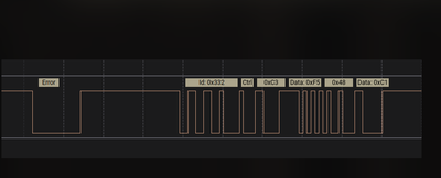

Hello.
I am developing CAN communication protocols using STM32F429.
However there is a problem in sending CAN frame data.

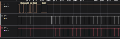

Here is a picture which I captured in CAN TX using logic analyzer, and as you can see, the series of data is losted after first data.
I tested this with publishing 100Hz, this problem occurred once a minute.

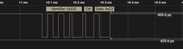

In normal case, it should be like this.
And also I add my code for helping to understanding.

I disabled the non-automatic retransimission and enabled automatic bus-off feature.
But I wonder why the retransimission did not occur.

You need to provide more details:
  • Your HW: which board? Your own HW or ST board?
  • If possible schematics
  • Bus configuration, used transceivers.. termination resistors etc ..
  • What is the system clock source you're using: HSE or HSI?
  • Are you seeing some acknowledgement for the send messages?
Thank you.

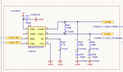

This is my own board.
Firstly, here is the schematic about CAN

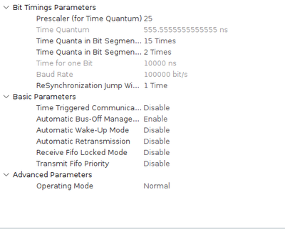

The clock source is HSE and it provide 45Mhz to APB.
I set up the configuration like below.
Add :
I disabled the non-automatic retransmission and enabled automatic bus-off feature.
But I wonder why the retransmission did not occur.
and attach another packet loss below

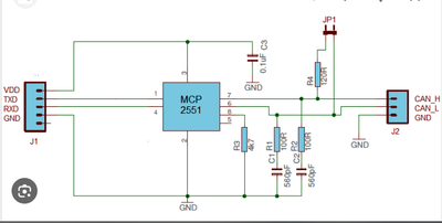

What is connected in the other side of the bus? does it have the same bitrate config 100kb/s?
What is the purpose of R23/C21 and R24/C22? it was the recommendation in DS transceiver?

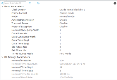

Also share your two projects: STM32F429 and STM32G0 (at least the ioc files) so I can look at them later.
February 21, 2024
I can't show all my code because of the confidential. Instead, I show the CAN part of my codes.
here is the G0 code which is responsible for receiving the CAN frame.
