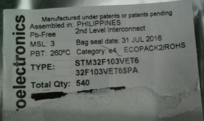

I was using STM32F103VET6 (LQFP) for 3 years. At this time, we found some parts' pins were dark and the showed assembly in Philippine. Last lot parts came from Korea which were fine. So we followed AN2639 document to take a test for soldering but they were failed (The same test for Korea assembly parts were passed.) Then we sent to testing lab and Philippine's parts were failed for soldering either. We need some new instruction for settle this case.

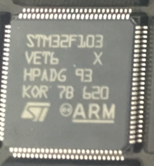

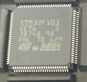

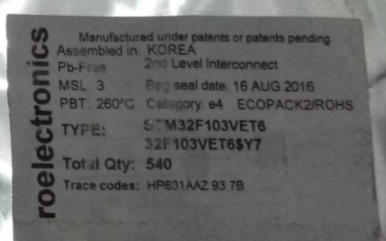

I guess any quality analysis would require at least a picture of the package marking and a picture of the sticker reel (which would give origin info) for anyone to dig further.
‎2017-07-19 12:22 AM
Here are the label and marking photos.
‎2017-07-19 12:37 AM
Perhaps not packed correctly, and some corrosion from moisture ?
IMHO better check with your FAE or sales representative, ST will most probably not tell about production details and issues here ...
