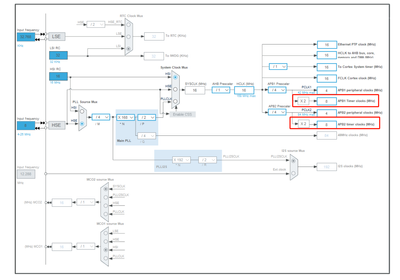

What's the value of Prescaler and Counter Period?
You can calculate the timing time using the following formula:
fclk/(pre+1)/(counter+1)
You can get the clock of TIM2 through the Clock Configuration of CUBEMX.This is the simplest method。
For example:
Sarra.S
Hello @Ezgi
This is due to the different clock configurations when changing the SYSCLK source from HSI to PLLCLK.
TIM2 is clocked from the APB1 clock, and when you switch the SYSCLK source to PLLCLK, the APB1 clock frequency is different ( you can see that using CubeMX as suggested by @Elatewendy
