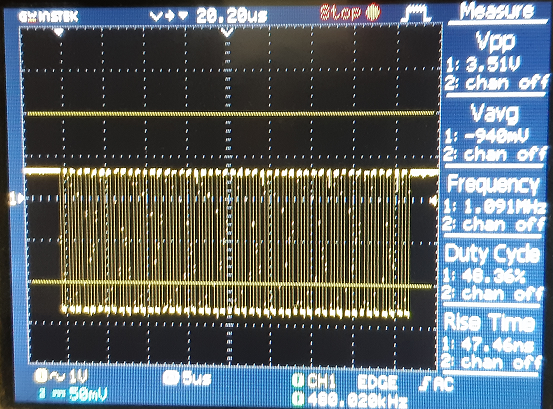

For communicating with a sensor I need to send 32 bits as a clock for my sensor. As you can see in the 8-bit data transmission an interruption occurs during sending 4 bytes which is unpleasant for my communication.
I wrote a Software SPI (bit-bang) with a timer but for low speed communication (even 200Khz) it makes my MCU slow (subroutine of time should be triggered each 2 us). How can I do for deleting the small interruption in Hardware SPI by using a software trick?

I am really appreciative of your responses.
Actually I want to communicate with a 32bit sensor and my signal form is acceptable. Today I was successful to remove the little delay between bytes.( I send 16 bits with 16bit SPI mode) as you can see the attachment.
And here is my sensor output which is completely correct.
But I don't receive the right value of my sensor. I want to know this function SPI_I2S_ReceiveData returns two bytes from each 16bits transmission or byte by byte?
