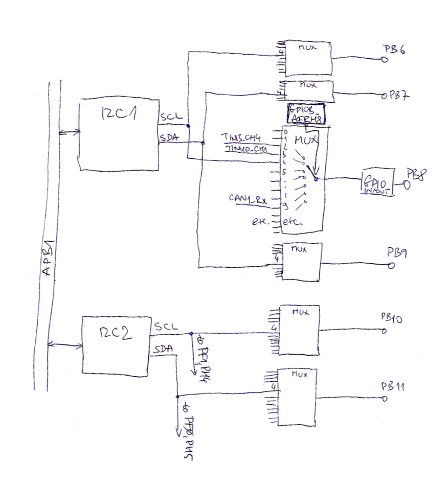

I am a little confused by the AF selection on some pins in the case of using multiple I2C's.
I am bringing up a new board where board I2C1 and I2C2 are being used on an F4 micro.
I2C1 is on PB6 & PB7, I2C2 is on PB9 & PB10.
Looking at the MCU manual, it shows for the GPIO AF multiplexer: 'AF4 (I2C1..3, I2CFMP1)'
If I set PB9 to AF4, how is there a distinction between the pin functioning for I2C1 or I2C2?
#i2c #gpio #f4

The pin routing on individual pins is clearly shown in the Data Sheet tables. AF Mux on the pin is a 16-to-1 routing, I2C1 presumably has NO routing to PB9, where AF4 is connected to an I2C2 SDA node internally.
Each pin has its own MUX, each mux connects to different NODES.

That confused me, so looking at the manual, I saw that indeed AF4 was allocated for I2C1..3. But what I missed was that AF9 is also a candidate for I2C1..3 connections.
Now that I look into the actual pin function matrix in the device datasheet per your recommendation, I do see that for PB9, AF4 = I2C1_SDA, but AF9 = I2C2_SDA , for PB9.

So I just had to be cognizant of heterogenous ,mappings for the pin muxes, and make the right choices for my project using the old ST libraries.

Posted on March 17, 2018 at 06:23
Thanks for the diagram. I don't think this exactly captured the point I was confused about, but nearly: if there was a wire from the I2C2_SDA node up to AF9 of PB9, that would reveal what I was missing.
Posted on March 17, 2018 at 10:02
Should you tell us the particular mcu model you had on your mind, I would have probably guessed what's the source of your confusion and I'd put that wire there.
