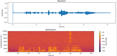

Hi everyone,
I’m working on an audio recording project using the STM32H747-DISCO board with its built-in PDM microphone. The recording works — I can clearly hear my voice — but there’s a constant background white noise in the recording. I’m trying to figure out what’s causing it and how to reduce or eliminate it.
I’m using STM32CubeMX + HAL, with a standard SAI + PDM2PCM configuration. The WAV file is saved to an SD card using FATFS.
Here are some key details:
  • I’m not using any prefix or divider for the sampling rate — I simply feed the microphone with a 3 MHz clock via SAI4A with "User Set Master Clock Devider Value".
  • I’ve achieved the most satisfying results so far with these settings:
  • SAMPLE_RATE 24000U
    PDM_DECIMATION 128U
    PCM_SAMPLES 1024
see my config below:

AScha.3
How much noise ? (try some audio program, FFT, to get a number of - xx dB noise level)
Because every mic will have background noise, so the question is: much more than it should have,
or -depending on your settings for Fs and decimation- about the expected noise ?
I made fast Python script for that:
Noise floor: -51.33 dB
Noise level: -25.31 dBFS
I'm surprised by this noise because in the BSP example for this devboard there is an example with recording and playing sound and the sound is very clear.
cool.
Did you check the signals on mic : clk , D ? frequency ?

I checked the clock and it is getting the right frequency
MasterT
Lead
What is the main clock source? I see, that CubeMX starting project with HSI.
From my experience, HSI should not be in use if  analog signal processing required, no with adc or dac.
Seems there are 20 MHz crystal, try to reconfigure your clock tree
Good point! I'll check it out
