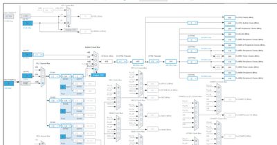

Hello, how can I get timers running at 480Mhz to have maximum resolution?
Here is a capture using latest stmcube version:
I have tried D2PRE1 & D2PRE2
=1 but then warnings appear

‎2023-12-11 6:43 AM
Hello @JLope.11,
No, this frequency is out of range for timers, maximal clock for timers is 240Mhz
you can use HRTIM for high-resolution that can reach 400 MHz (check Timer resolution and min. PWM frequency Fhrtim in RM )

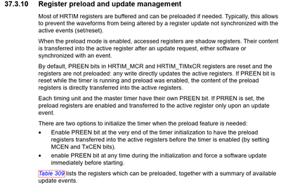

‎2023-12-13 1:40 AM
>But I do not know if the changes are done in the actual PWM cycle or in the next.
rtfm

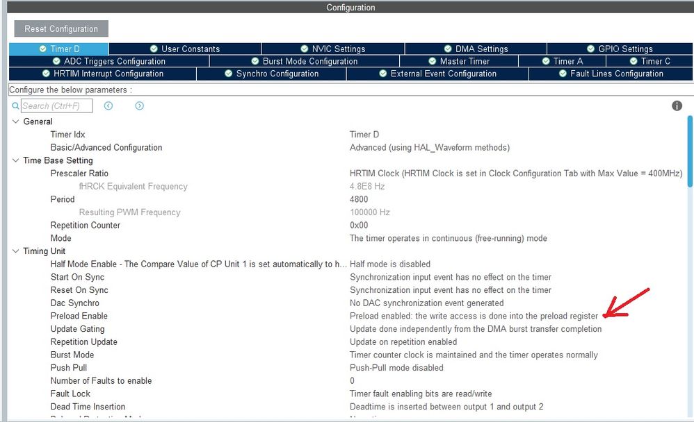

‎2023-12-14 12:58 AM - edited ‎2023-12-14 2:09 AM
I found it at the stm32cubeide:
By default it is disabled.
In other way how to manage the complementary mode?, I have programmed the timer D-1 and 2, if I make push-pull I can not set the dead time. With dead time I do not know if it is connected the timer D-1 with compare unit-1 and timer D-2 to the compare unit 2 and if it is delayed pulse of the D2 automatic
I run the code but no signal is generated. Seems that something must be done to make timers run or activate the lines, something like this but for stm32h7xx:
LL_HRTIM_EnableOutput(HRTIM1, LL_HRTIM_OUTPUT_TC1 | LL_HRTIM_OUTPUT_TC2);
/* Start HRTIM's TIMER C */
LL_HRTIM_EnableIT_REP(HRTIM1, LL_HRTIM_TIMER_C);
LL_HRTIM_TIM_CounterEnable(HRTIM1, LL_HRTIM_TIMER_C);
Exist an example code?
‎2023-12-14 3:10 AM
see:
so between TA1 and TA2 outputs.
